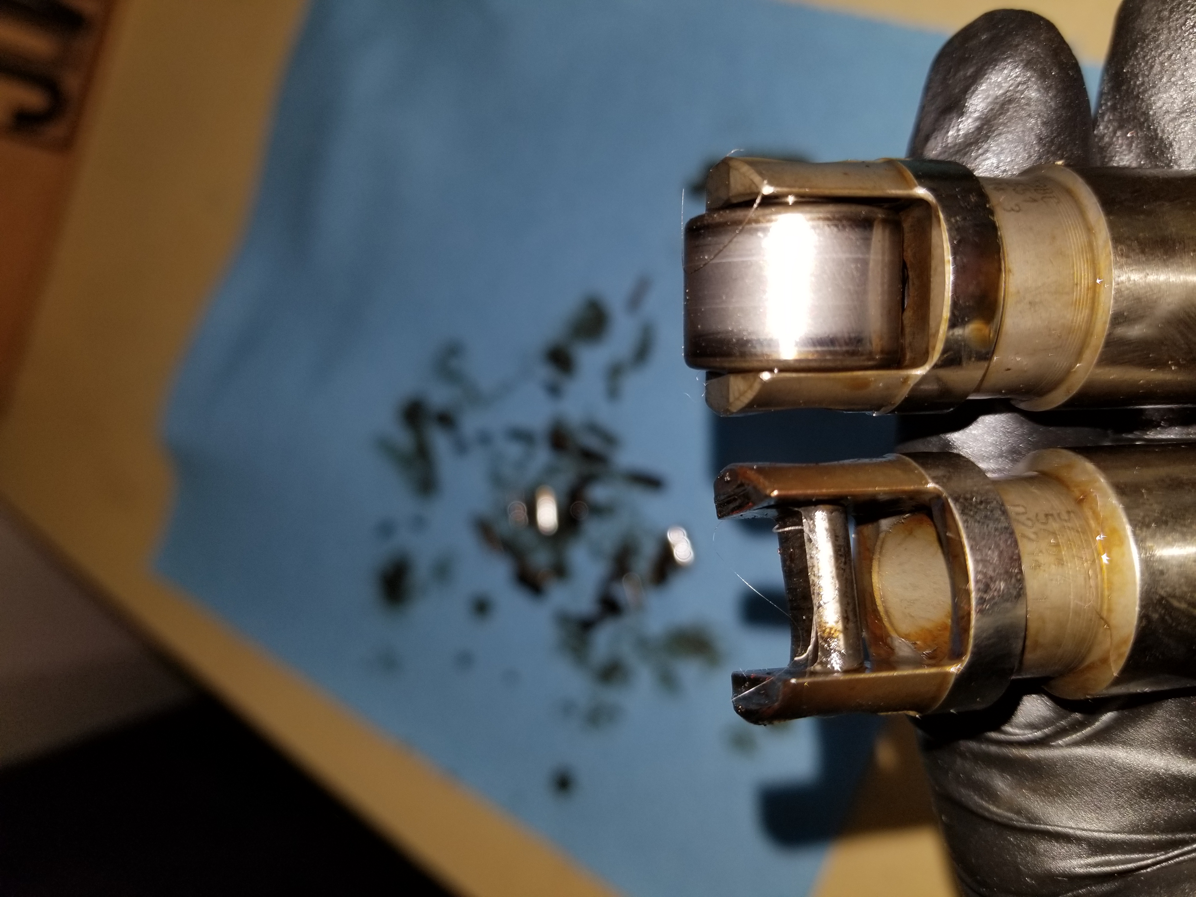

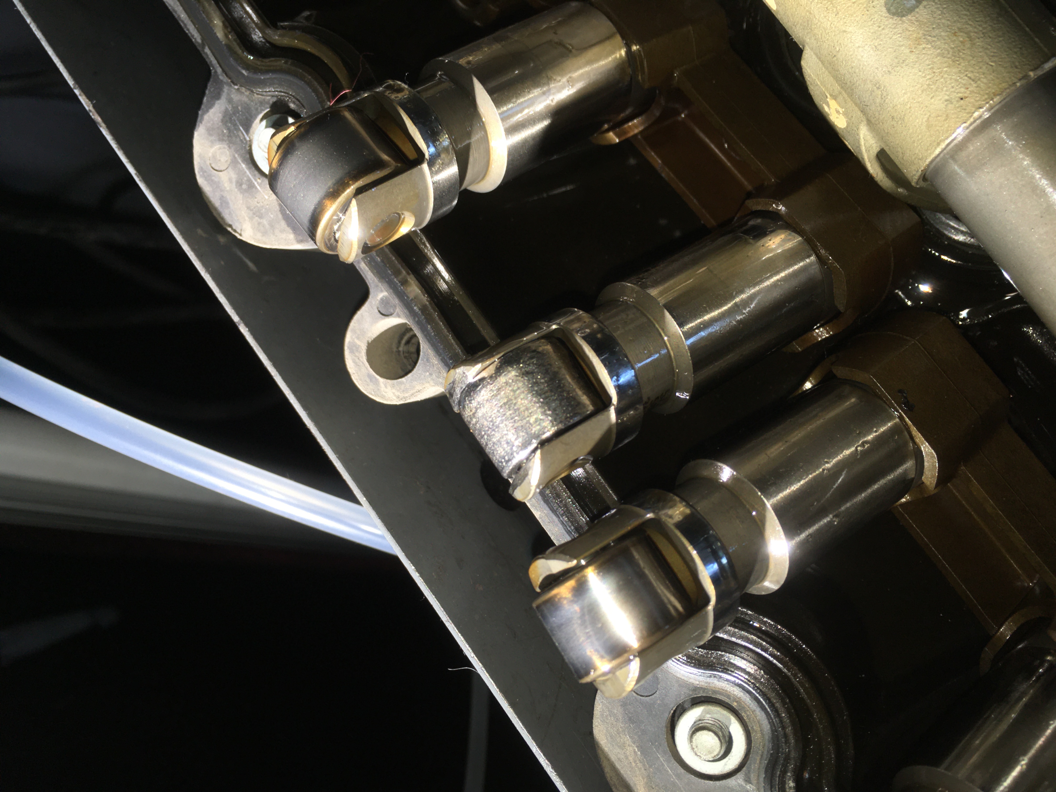

Got the dreaded "hemi tick" on my 2012 PW with a Number 3 and 7 cylinder misfire code.
Currently at the local shop getting new parts i.e. 16 lifters, 1 cam, gaskets etc.
Heads are getting sent out to get checked and machined as well as the valve seats re-ground.
Tech will check timing chain and water pump as part of the cam job.
$5600....ouch.

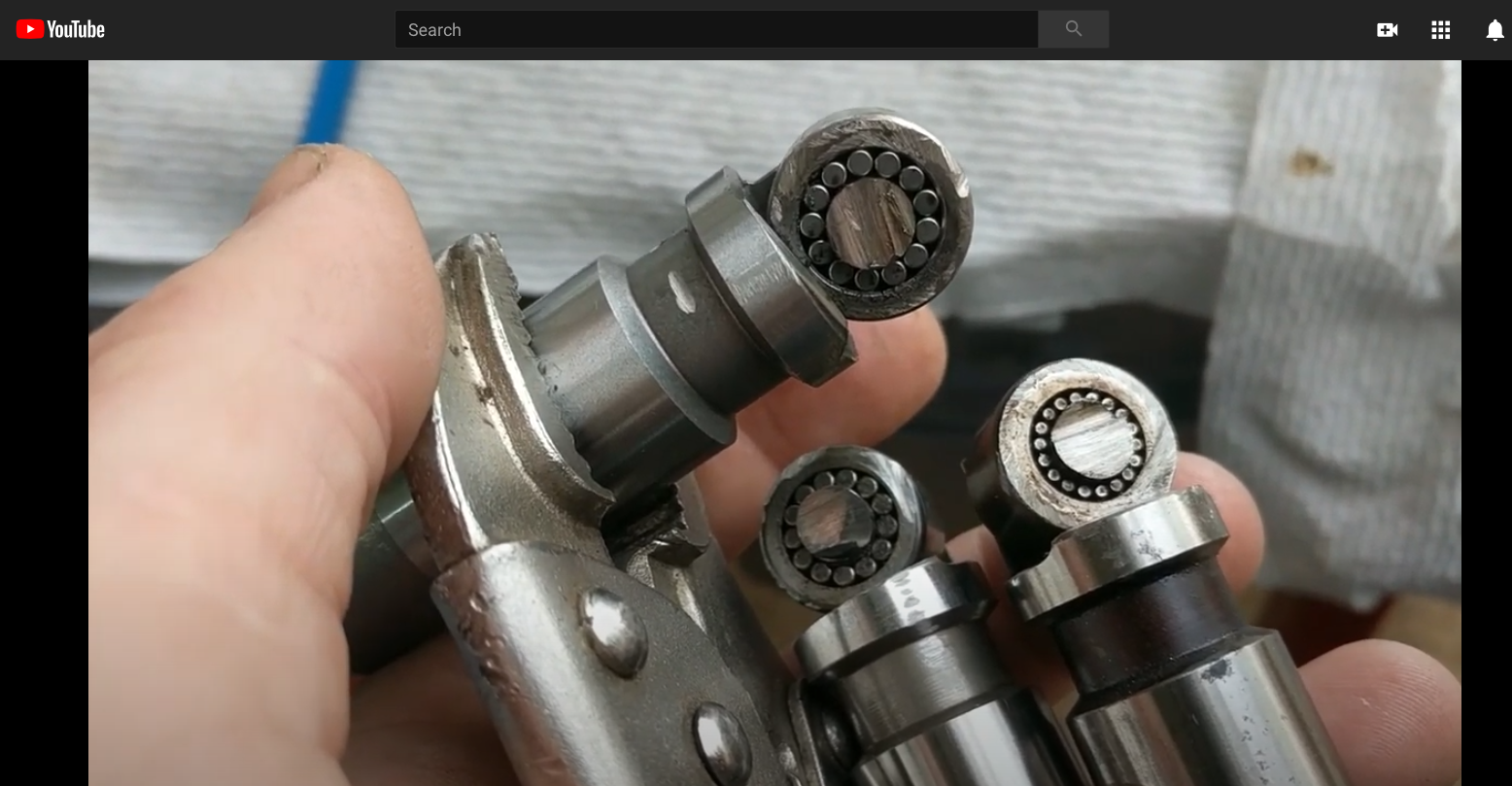

***Update*** FYI....Lifter Part number for Gen 3 Hemi (2012) 0503 8784 AD. These are the updated lifters. Haven't confirmed but I believe they are similar to 0503 8787 AD with the larger needle bearings. Darth Hemis youtube video shows the differences in the needle bearings.https://www.youtube.com/watch?v=u5MGGl_5tl0
#3 cylinder Lifter

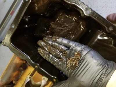

The only thing making me feel better is a co worker had the same issue with his 5.7 Hemi 1500 Ram but had to replace the entire engine due to the lifter roller blowing up and sending needle bearings and metal fragments into his oil sump.
Dealer quoted him $18k for a new motor. After fighting with insurance for a month, he balked and bought a rebuild from a local shop for $2500 but wound up spending $5000 total after install.
Pics of his detonated lifter roller bearing.
