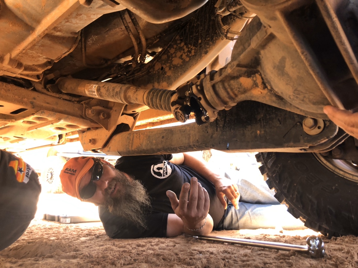

This is what spinning tubes looks like, under a manual transmission Cummins. Cause was excessive tire bounce, and a manual transmission. Power Wagons tend to get away with a lot more.

Wow! That picture really tells the story!

I need royalties every time you tell this storyDamageWagon wrote: ↑Thu Nov 21, 2019 11:36 pmReally no point in welding the tubes unless you truss it, with the exception being if you had a diesel and you crawl with it. Otherwise, I’ve not seen power wagons spin tubes. Either do a full truss or leave it be.
Re: Welding Axle Tubes
I will ask royalties for spreading your nameDarylB wrote:I need royalties every time you tell this storyDamageWagon wrote: ↑Thu Nov 21, 2019 11:36 pmReally no point in welding the tubes unless you truss it, with the exception being if you had a diesel and you crawl with it. Otherwise, I’ve not seen power wagons spin tubes. Either do a full truss or leave it be.
IMG_3232.JPGAfter a lot of thinking about the day prior to behind the rocks I'm going to attribute this to several bottom outs between the campsite & a few dunes. My bumpstop was loose on that side after getting home, signs that it bottomed out. You know it's all fixed and pretty now
I didn’t see your axle bent, I saw it pulled apart. It was impressive, and cool, and even cooler because it wasn’t mine.
