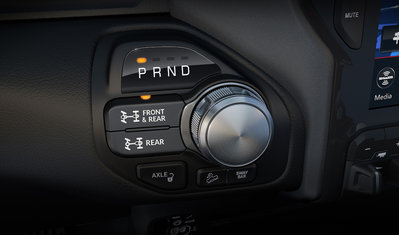

Ram just released connector diagrams for the 2019 trucks, everything has changed and the current locker bypass won't work on 2019 and newer trucks. When you compare the 2018 diagram to the 2019 diagram, you can see that all switch inputs have been removed. Now all control of the final drive control module (FDCM) is coming through the CAN C data stream apparently.
The next generation of locker bypass will need to be a reprogrammer or a completely stand alone hardwired unit. I'm not capable of manufacturing a reprogrammer, but I can build the other option and it would be plug and play with no cutting of wires. However it would more than likely set codes and turn on warning lights. :angry:
