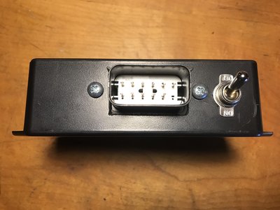

The 3rd Gen prototype is finished, adjusted and tested! It works perfectly! I ran out of time for writing the installation instructions, so I’ll be working on that the next couple of evenings after work.

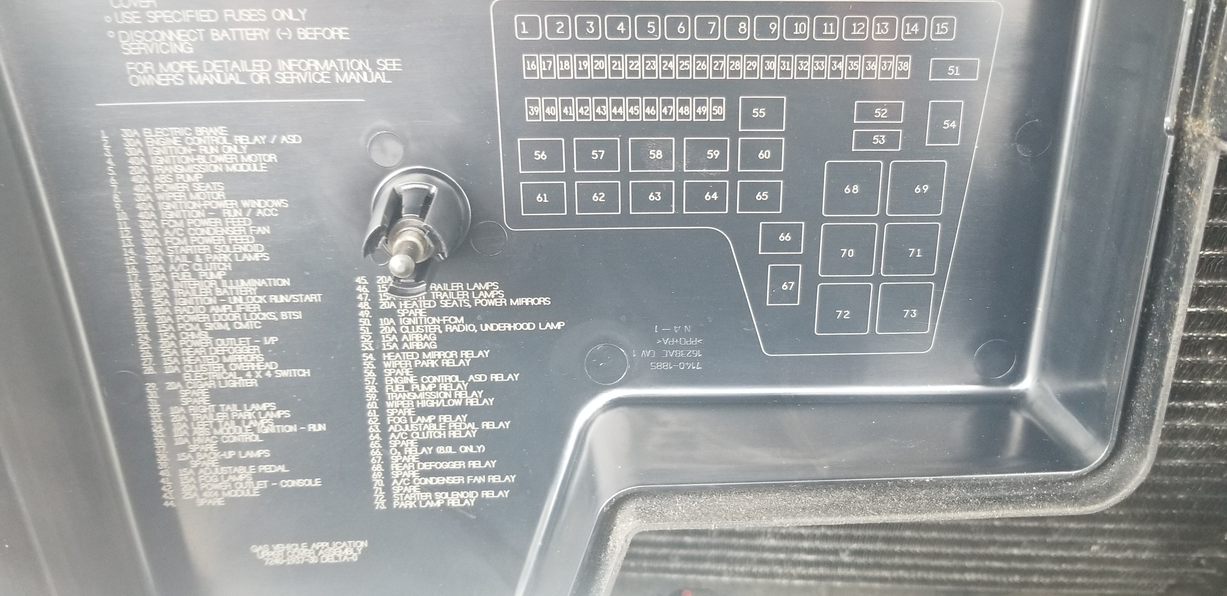

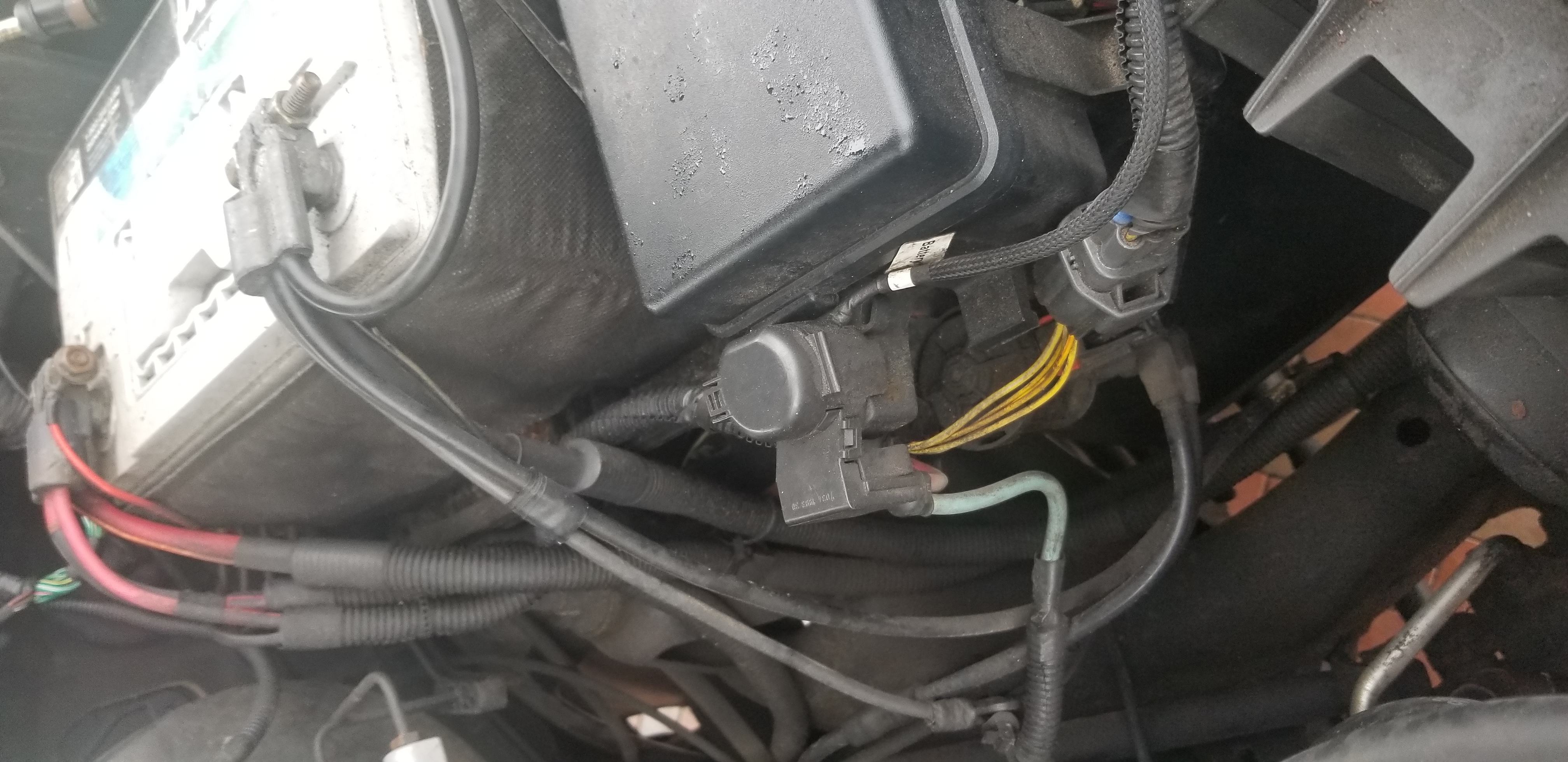

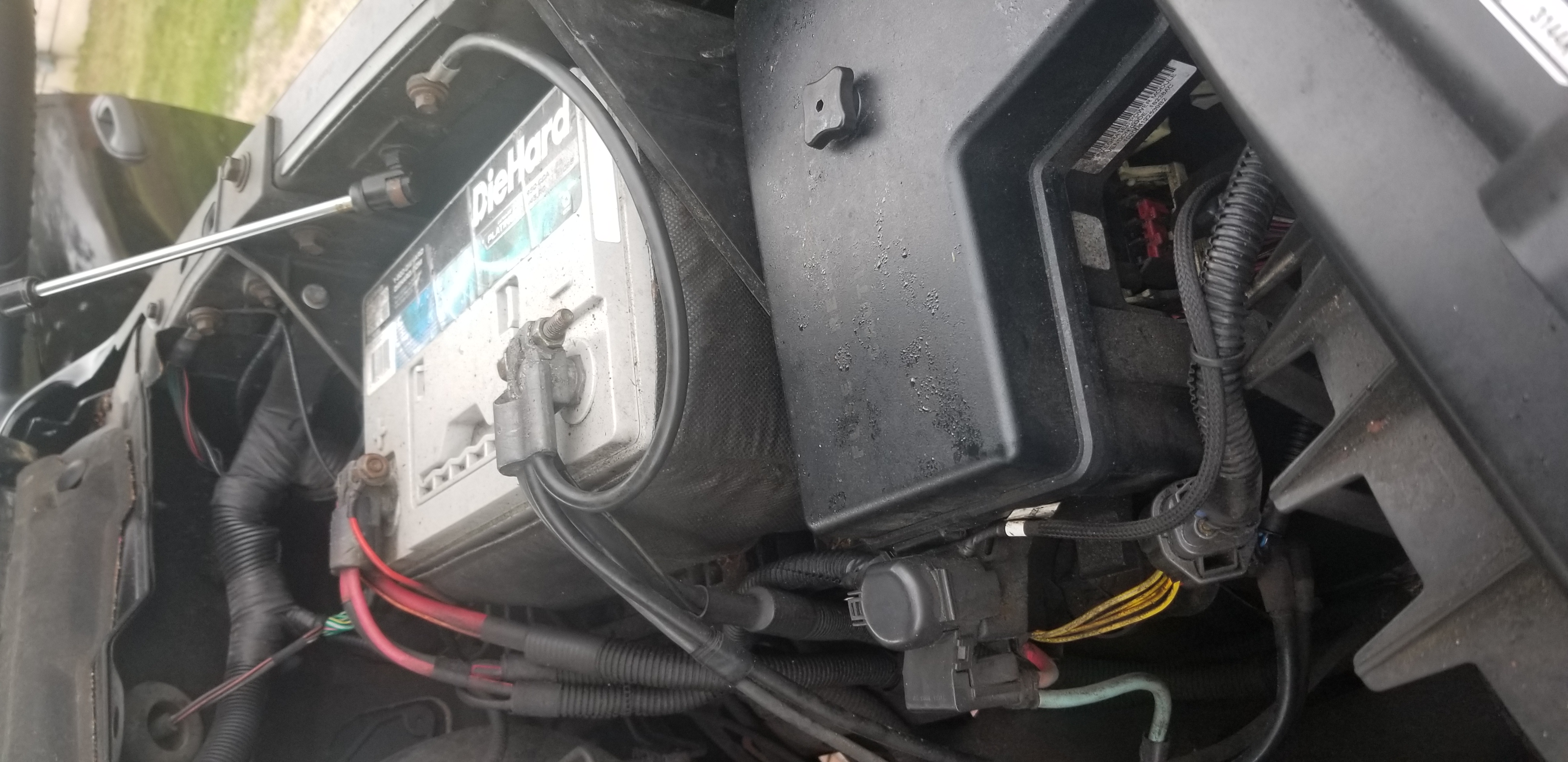

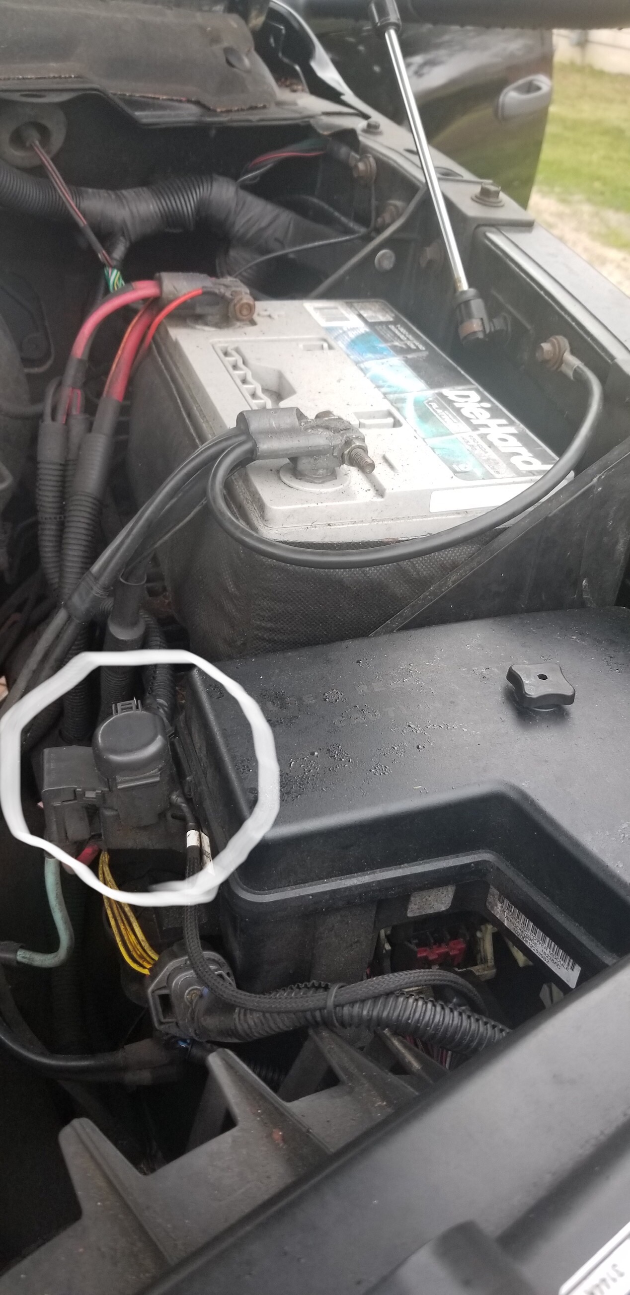

Could someone with a 2005 please provide a good, clear high quality picture of the fusebox/power distribution center by the battery? Specifically focusing on the positive battery post on the outside of the box. This picture will be used in the 3rd Gen installation instructions for the locker bypass. 2005 is different than the rest of the 3rd Gen years.
I prefer to connect to that power post and avoid the possibility of corrosion that exists at the battery.
Thanks! :patriot:

Post by w2dodge » Fri Dec 14, 2018 10:23 am
hope this helps...would've had the photos sooner ..had surgery on my shoulder Wednesday...let me know if you need more pics
