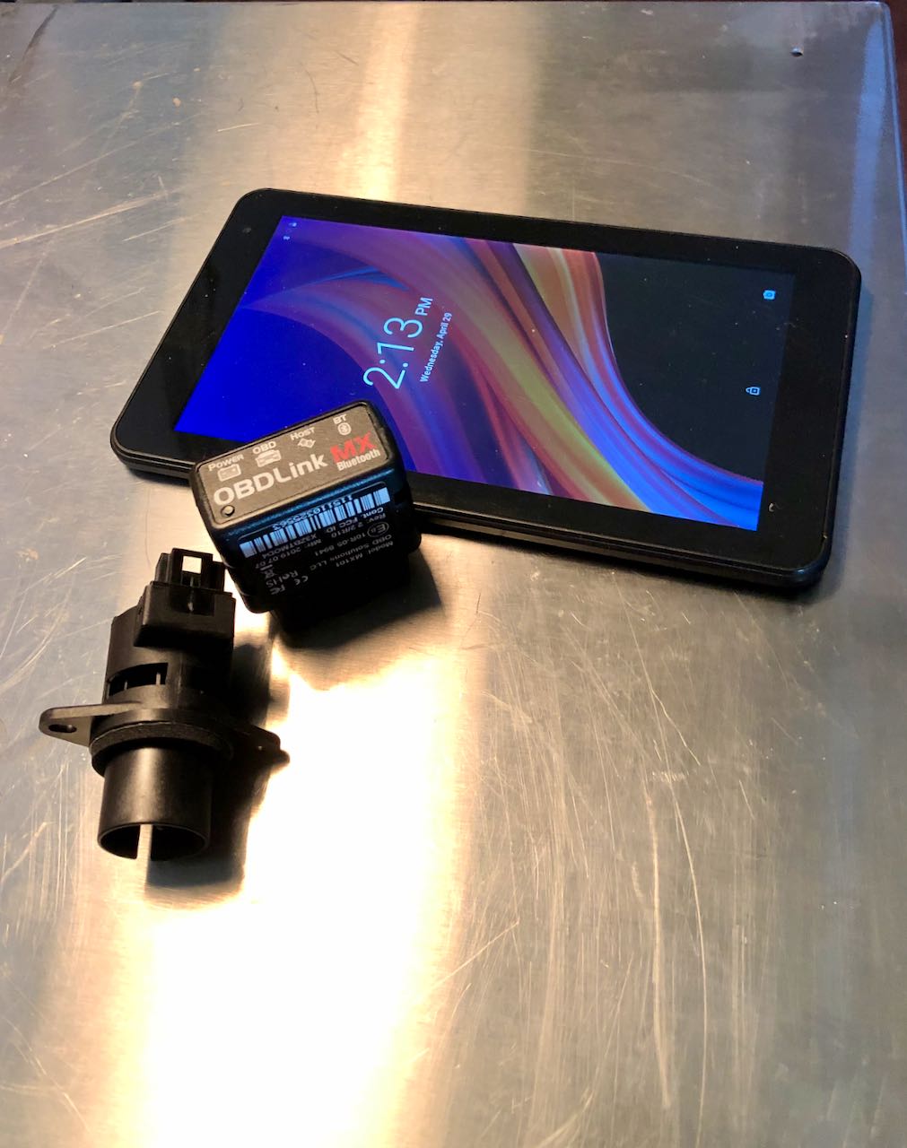

After getting AlfaOBD to set tire size/psi I started looking into other things that could be done and stumbled upon a thread in RAMForum on changing from manual temp control over to auto. Apparently on our 2500 trucks, things are a bit different as we do not have a variable compressor like the 1500's do, so there is no humidity sensor that also needs to be installed, making the conversion fairly simple. For my '16 just temp sensor 55111178AC was needed, $45. The sensor goes in the DS knee bolster, and the plug was just electrical taped by hand to the rest of the under dash harness. These are the steps I took with Alfa:
- Connect to Body Computer > go to "raised hood" icon > Car Configuration Change (bottom of list)
- Scroll down to Vehicle Configuration 3: HVAC Configuration:
- Select Dual Zone ATC
- Disconnect AlfaOBD app & shut off the truck and exit for a few minutes (you must wait for the Dual Temp sliders to display on the 8.4 radio before proceeding with single zone ATC change. I waited 30 min)

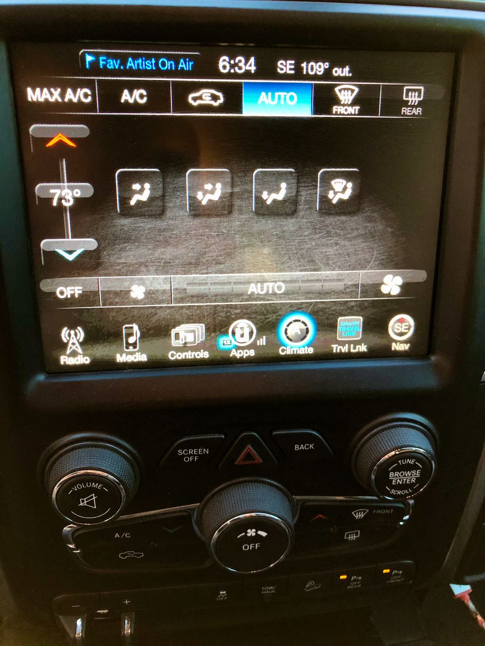

- Start truck and verify dual zone auto and voice temp control.
- Shutoff truck and go back to same settings on Alfa, this time select: Single Zone ATC
- Exit Alfa and the truck, again I waited 30 min.
- Verify functionality with voice and manual temp buttons.
