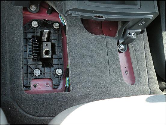

How to disassemble your console.

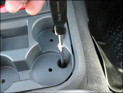

I had to disassemble my console again to hook up my KC back-up lights. So I decided to take some pic's this time for those who haven't done it yet. Tools needed. A 13mm for the bolt that holds the transfer case leveler on, 5/16 socket for a couple of bolts that hold the plastic, a Phillips screw driver for a couples of screws, and a flat blade screw driver for plying.

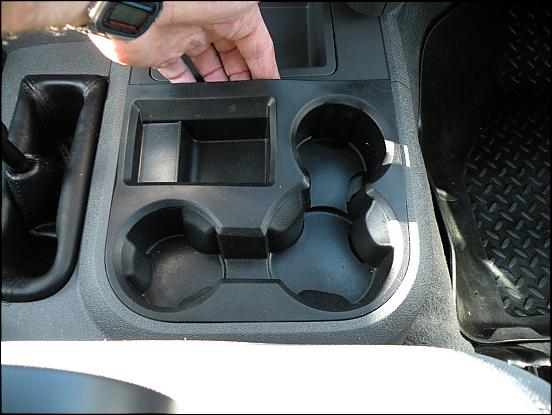

1st pic. You pick up on the cup holder and remove it.

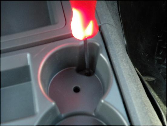

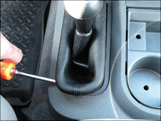

2nd pic. Take the flat blade screw driver and ply up on the BACK side of the boot. If you do the front, it WILL break.

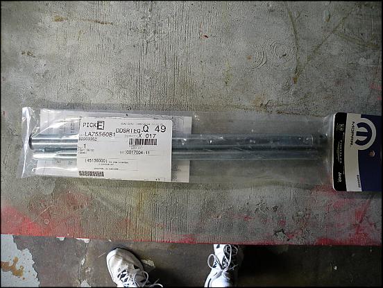

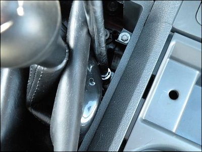

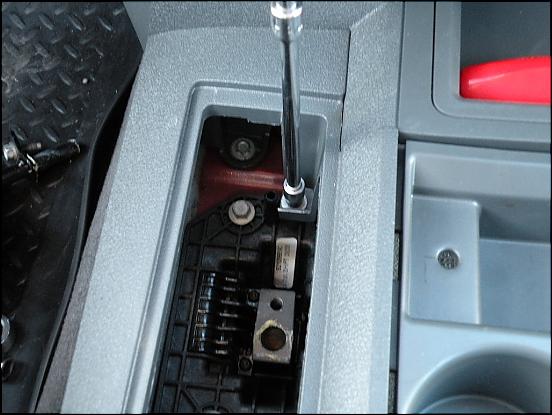

3rd pic. Use the 13mm socket and extension to remove the bolt and pick up the leveler out to the hole.

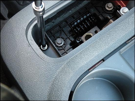

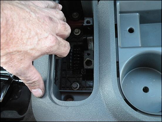

4th thru 9pic, Remove the one Phillips screw and 3 bolts.
Pick up on the left side and remove.
And this is what you have.
