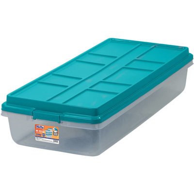

I'm curious... what kind of storage tubs have you found to fit under your platform?
Also, it's hard to tell in your slideshow pictures but it doesn't look like there's a support leg under the forward cross board, does it flex much or is it secured somehow that I can't see in the picture?
Re: Sleeping Platform Build
I went to several hardware stores, and the tubs I ended up with are actually hefty brand from Walmart. For a lot of the tubs that I had seen, the lids had an indentation after the lip of the rim, I liked these ones because the lid were raised instead. There is 7.5" clearance a the lowest points, and these tubs were a touch over 7".Retired BLM Rig wrote: ↑Wed May 09, 2018 8:55 amI'm curious... what kind of storage tubs have you found to fit under your platform?
You are correct, the forward crossbar (not painted) does not have a center support. It is attached with a bolt and T nut to the side boards at both sides of the truck. You can see some flex at the front most panels at the center, but it is minimal for normal use. I did not notice it when we were using it as a sleeping platform with mattresses installed. I considered adding another support, but I have no plans of doing so at this time.
