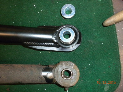

Re: 2006 Power Wagon new to forum
Can you take a picture of the front springs and control arms.

- Posts: 5550
The arms look straight with no bends in them. So they're not Carli or Thuren.
