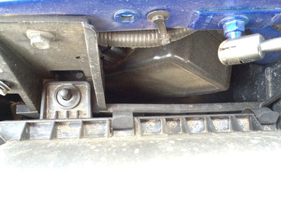

The kit is working GREAT in my 2014!!!! Used it hunting today and it worked like a charm getting me through a greasy mud hole in 4 hi with both diffs locked. Here are a couple more pictures of where I had to mount it behind the air box.

Looks crammed in there! LOL. So you were able to just remove the two bolts holding the airbox mount to the inner fender and squeeze it back there?

myoung84 wrote:Looks crammed in there! LOL. So you were able to just remove the two bolts holding the airbox mount to the inner fender and squeeze it back there?
That's exactly what I did. It is a tight fit!
