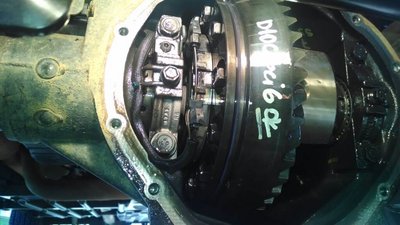

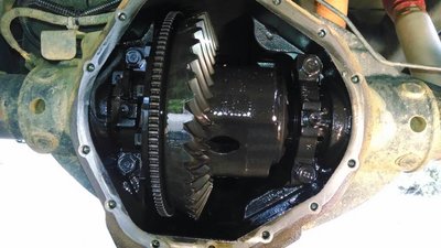

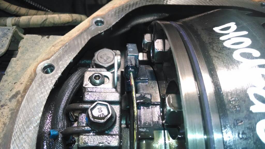

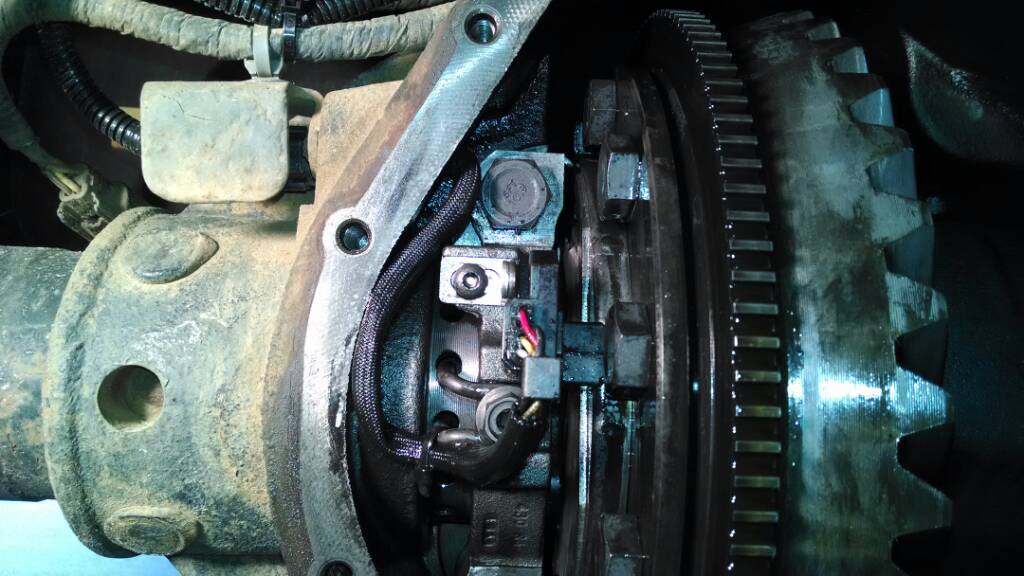

OK, finally went into the differentials. I wanted to try the bypass before cleaning the magnets. The lockers have worked perfectly since I installed this bypass. I have over 95k miles so I finally cleaned it all up and put fresh Amsoil Severe Duty Synthetic in. The magnets were covered with an 1/8" thick layer of metallic sludge yet they still worked flawlessly bypassing that not so smart bar. [attachment=-1]uploadfromtaptalk1399136639232.jpg[/attachment][attachment=-1]uploadfromtaptalk1399136667291.jpg[/attachment][attachment=-1]uploadfromtaptalk1399136689976.jpg[/attachment][attachment=-1]uploadfromtaptalk1399136705380.jpg[/attachment]
