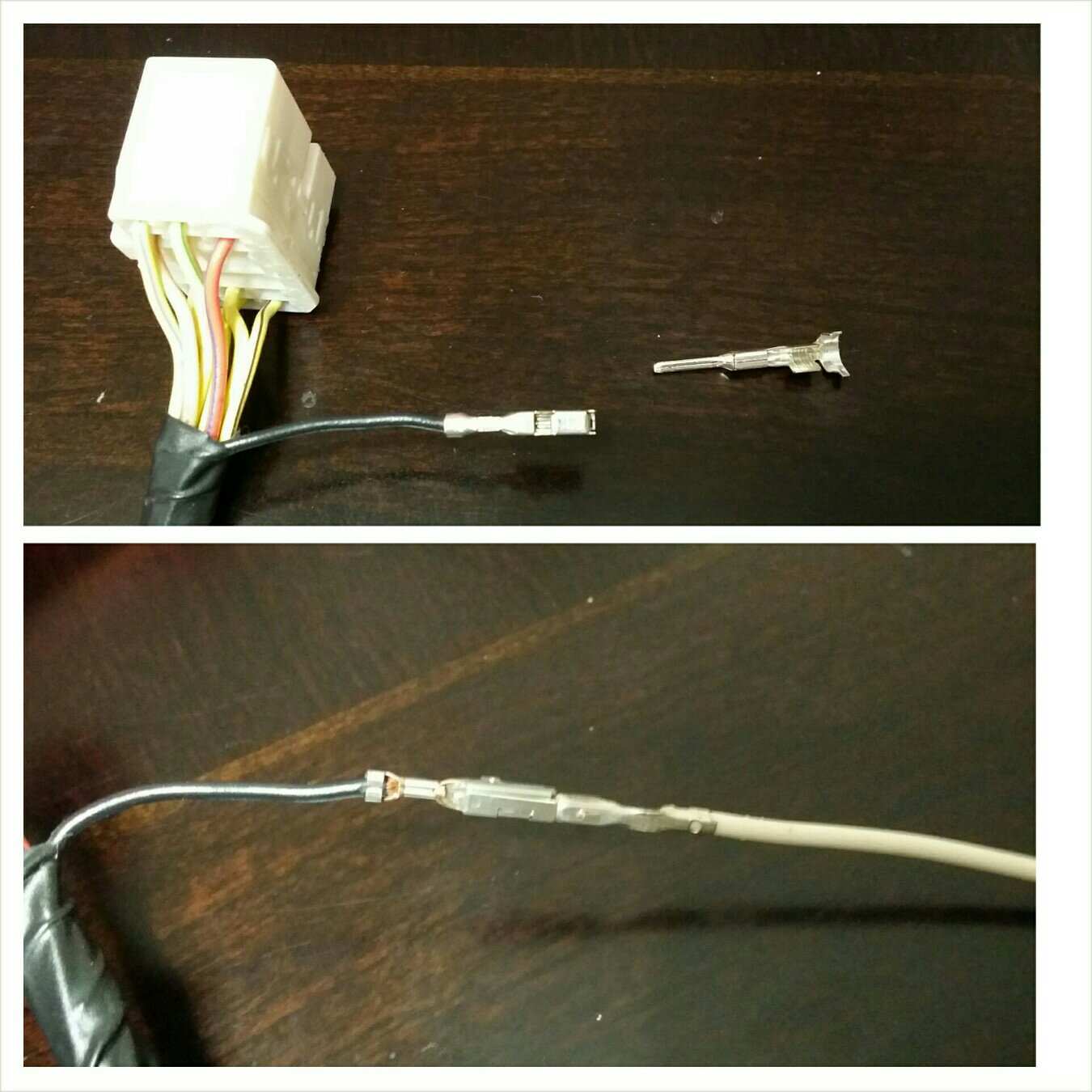

Re: 3rd Gen Smartbar Locker Bypass
Scratch the idea of tapping into the harness at the smartbar. It's a colossal pain in the ass to disassemble and pull the pins. Here's what I'm proposing for harness under the dash. Pulling these pins is simple, just need a tiny flat head screw driver. Cover the connection in shrink tubing and we're good to go. There are three connections like this and two additional will have posi-taps.
looks simple….are they hard to get to…il keep looking..
That I don't know. Rws5040 was kind enough to send me a full harness so I have the connectors but don't know exactly where this connector is located. Only thing my info shows is under the driver side dash.
Found them! As long as I purchase 100 of each connector and a 5000 piece reel of each terminal. Yikes! I've asked if there's any possibility of reducing the MOQ but it's unlikely. Based on the amount of this single purchase, overall kit pricing will jump up quite a bit. If I can get a slightly lower quantity, I'd still prefer the T-harness, bit I don't think the additional cost is worth it.
What are everyone else's thoughts on having to pull pins from the connector under the dash? Price would stay at $250...
Keeping the factory look on the dash side and having it work every time would be worth it to me. Not like I have a warranty any more to worry about.
