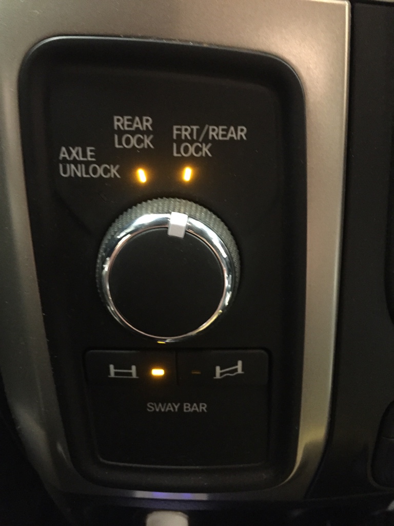

This is what I have lit up when selecting front & rear lock

Re: Back on the wagon
Is that what is causing both lights to come on?
