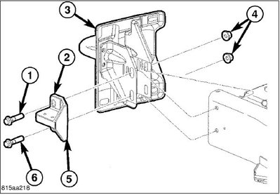

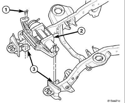

Can you simply move the winch to the bumper or does this requires more modifications? I though I read somewhere that you have to reverse wind the winch, which I would think would be bad since you'd always be winching against the drum brake...
Re: Road Rhino bumpers
You should just be able to bolt the winch right into the bumper the same orientation it is now. Correct me if I am wrong, but the mounting bolts for the winch in the stock position enter from the front of the truck and fasten horizontally into the winch, right? That's how the bumper mount is too. The only thing you may need to do is re-route or possibly lengthen the power and ground cables.
Let me know if the winch mounts differently than I described. I looked at some pictures of the mounts on Google.
