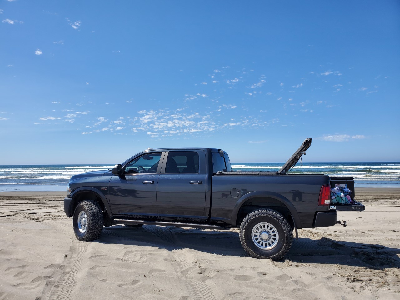

I just put the ST Maxx 37x12.5x17 on AEV salta wheels +28 offset on my 2018. I have a little rub on the drives side where my mudflap is/was. So far i have decided that i can live with the small amount of rub that i hear on certain angles. i may decide to trim the pinch weld later on. I use the AlphaOBD to reset my tire size which seems to automatically readjust my transmission shift points.I also use the alphaobd for tpms settings too (and about anything else that is adjustable)
