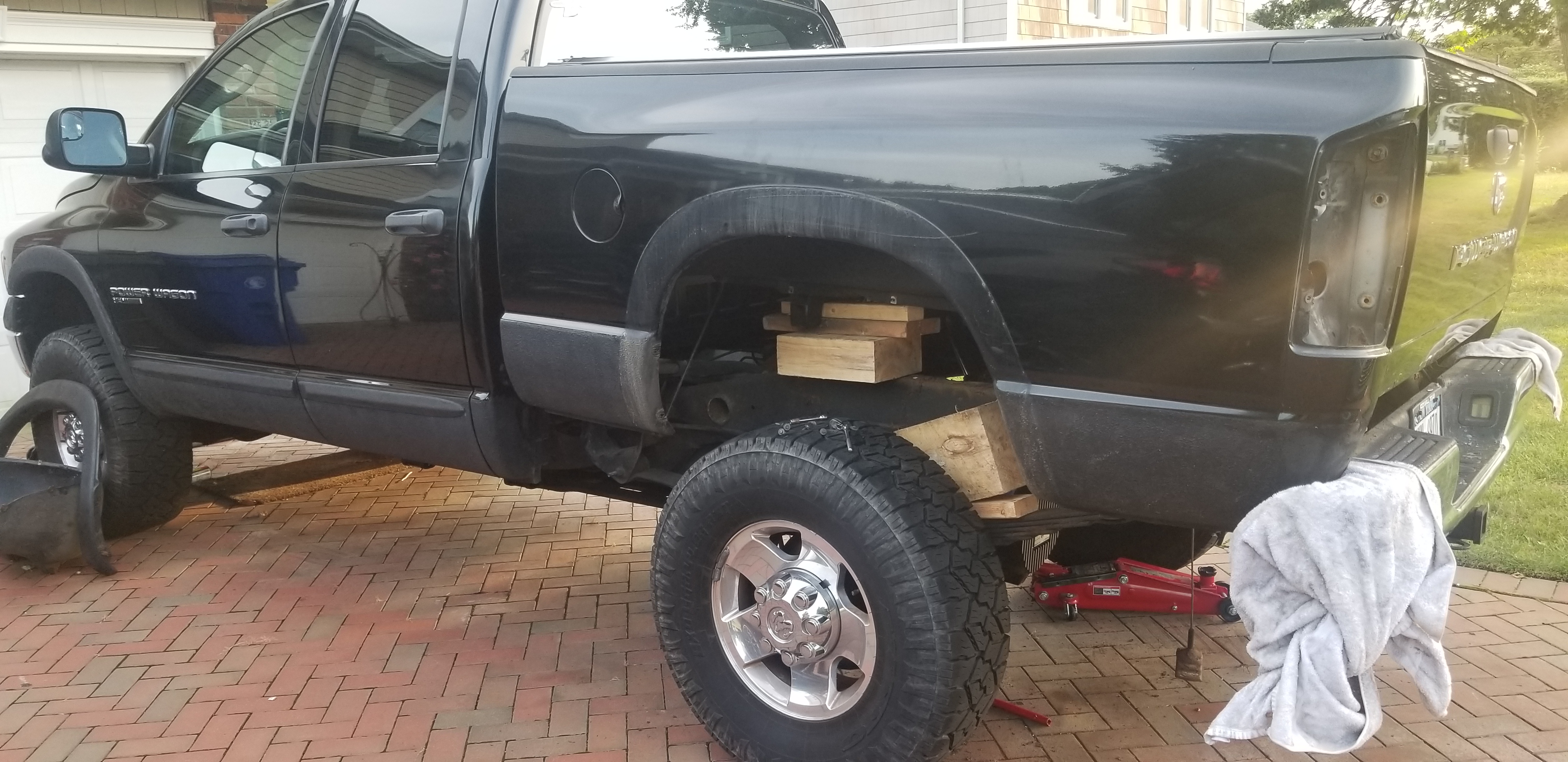

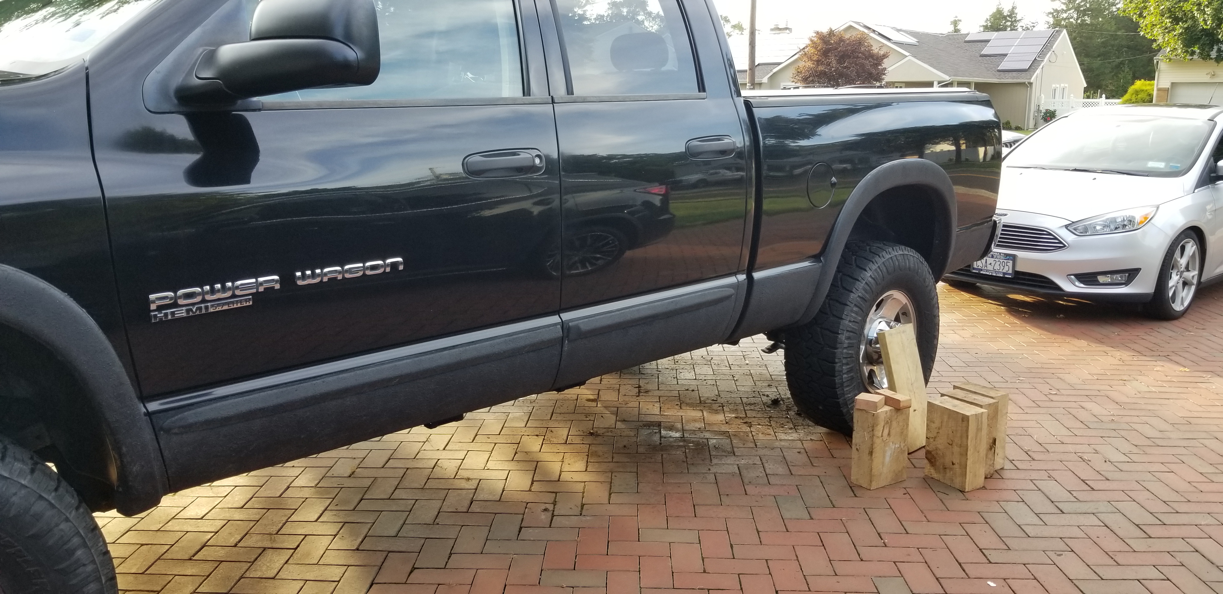

Post by w2dodge » Fri Aug 21, 2020 6:53 pm
getting there

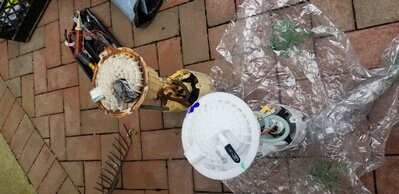

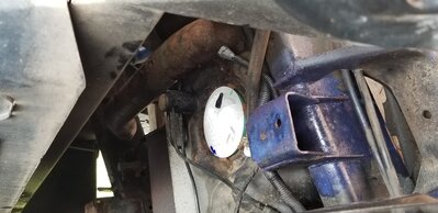

Post by w2dodge » Sat Aug 22, 2020 11:26 am
heres some progress

Post by w2dodge » Sat Aug 22, 2020 6:57 pm
all done... 1 of many things I gotta do...had shoulder surgery and a total hip replacement in the past year and half.. .
