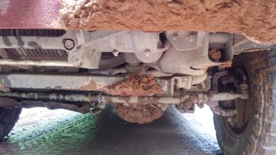

Re: Diff Protection AAM 10.5/9.25
I went with the Rock Crushers when they first came out.

- Posts: 5568
They are. They weight about 20 lbs each. Made out of cast steel. In the first pic. The white on the lower right corner of the cover is from hitting boulders. If you look at the boulder that I'm sitting on. You can see the scratch marks on it from where I drove over and then backed up.SimonandSimonBeast wrote: ↑Sat Jan 25, 2020 3:38 amHaha. They should come up with a mud colored powder coat. The Rock Crushers look really stout.
