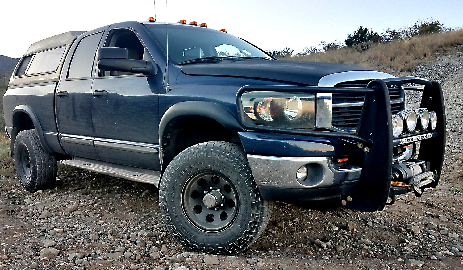

Post by 04Ram2500Hemi » Fri Nov 01, 2019 12:55 pm

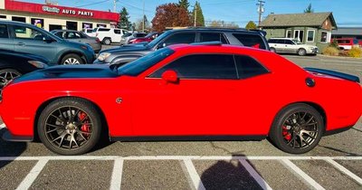

I can't imagine adding more HP to my Hellcat. 707hp is enough to get my ass in trouble, especially with a CDL! :D
LOL! Yes sir, I know the feeling... If only I could get some 315s installed in the back! (295 Nitto's now, helps but it's not enough rubber to keep bad things from happening!)
What color Cat do you have? I have a 2015, Jazz Blue A8. Just crossed 40K miles. Best car ever. IMO of course! :wink:

Mine is a 2016 Challenger in Go Mango with Brass Monkey Wheels. I put mine away for winter a couple weeks ago with just over 10,000 miles.
