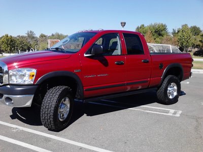

Hello zooroadbaja, where are you located? I've been thinking about selling my PW it has everything you're looking for and is in excellent condition inside, outside and mechanically.zooroadbaja wrote: ↑Tue Jul 30, 2019 10:15 pmIve been looking for a 3rd gen PW and doing some research on the side, some of the things ive read were after market winches are better, locker sway bar switch goes out so replacing sway bar and rewiring lockers. With all that being said would i be better off buying a regular 2500 and adding a bumper, winch, rear locker, and carli lift? Hope that makes sense.
Re: 3rd Gen PW question
Now thats a nice looking pw right there, coder
She is a beauty.
