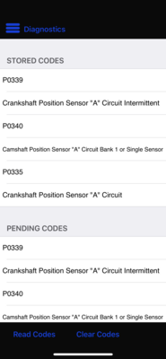

Had some terrible issues this past weekend.
Filled up with 93 at a Sunoco station i have never been to. It looks like shit.
Got to about 3/4 tank and the truck started having idle issues at low speed.
i put the truck in Park from Drive and it studdered and bogged out.
it would not start easily, and once it turned over, i got some codes. P0339 P0340 P0335

Am i in trouble, should i get it to the shop, or should i just replace the sensor?
do these really go bad in 20k miles?
And would these codes ever be caused by shit gas?

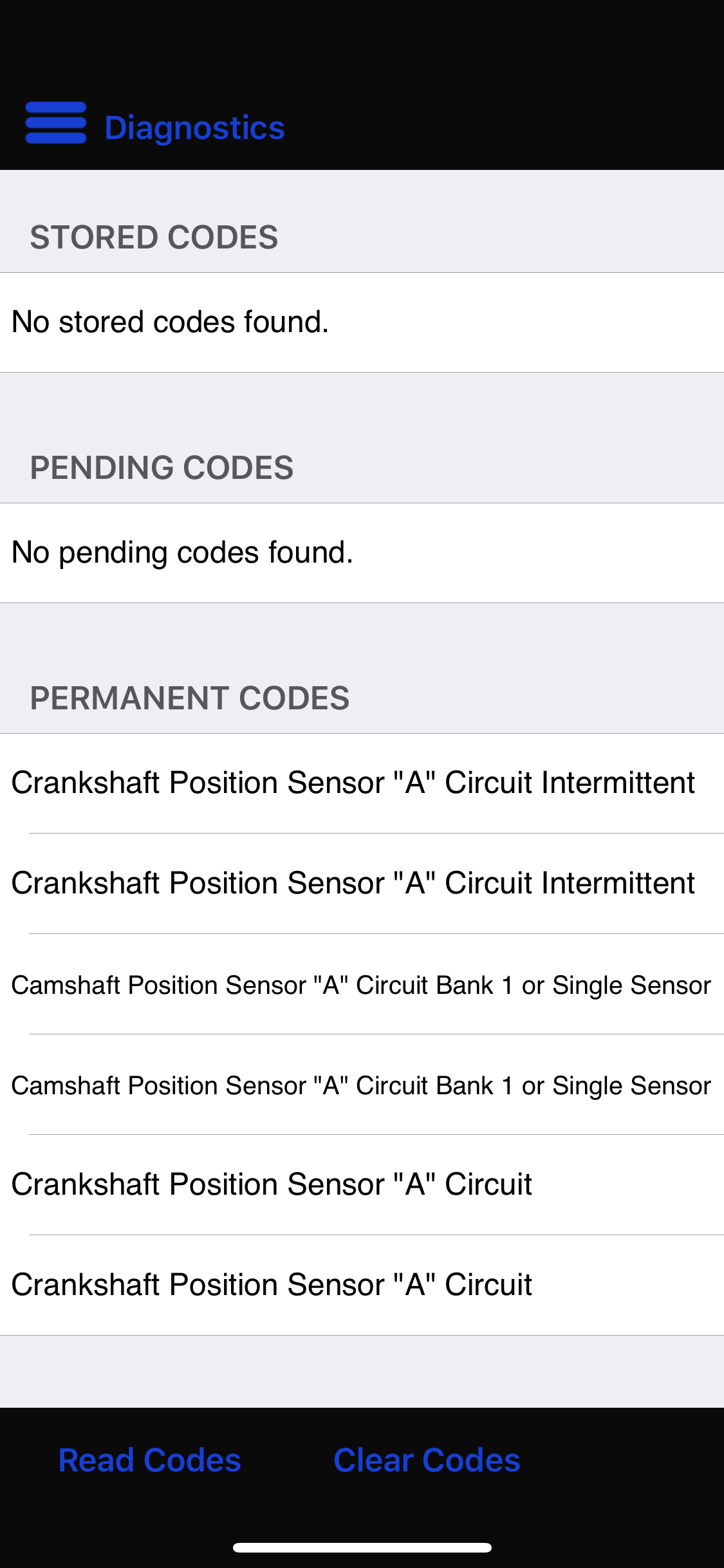

ive had the one code since removing the Edge.
driving ok and no more codes 24 hours later. crap50%-50%good blend with additives until empty. I hope no more codes.

well today its running....
ok
no more codes, and going to drop it off this week.
the 50-50 blend with additives is going through ok. trying to blow through it quickly.
