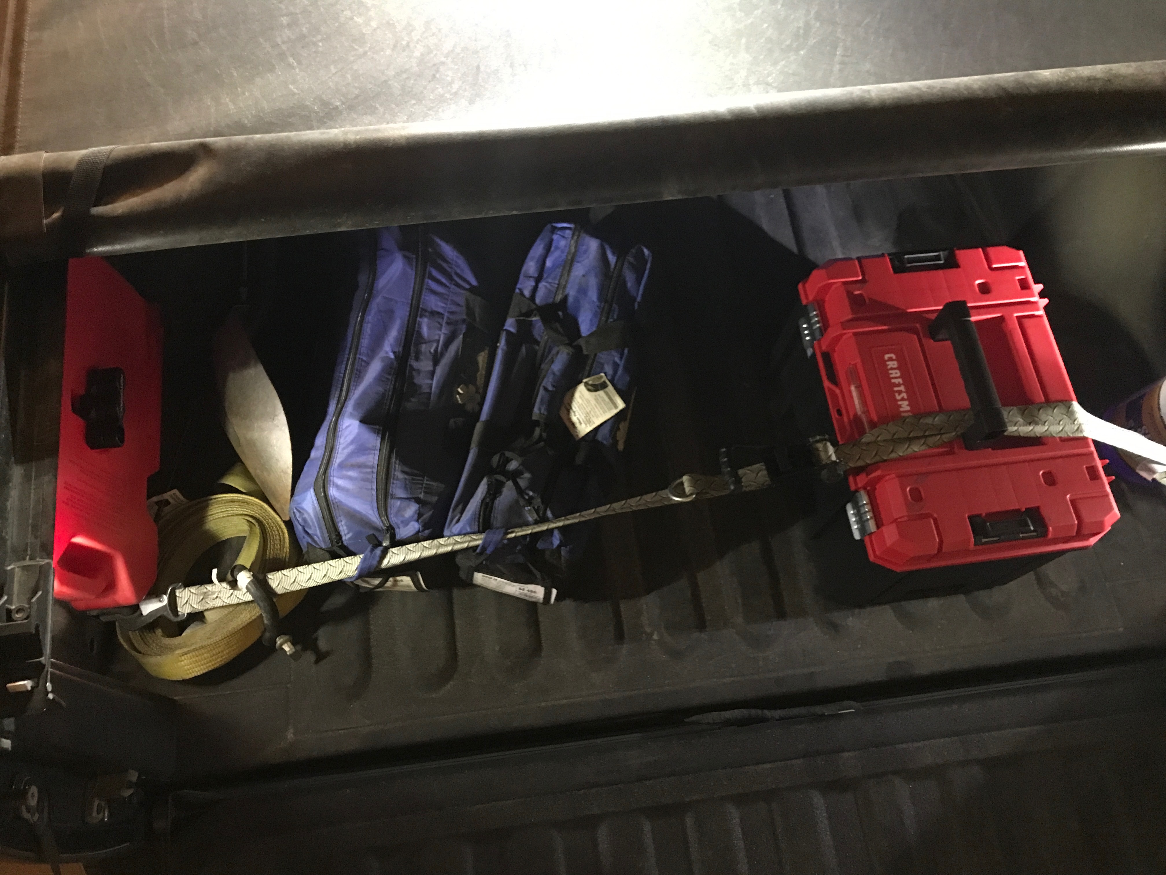

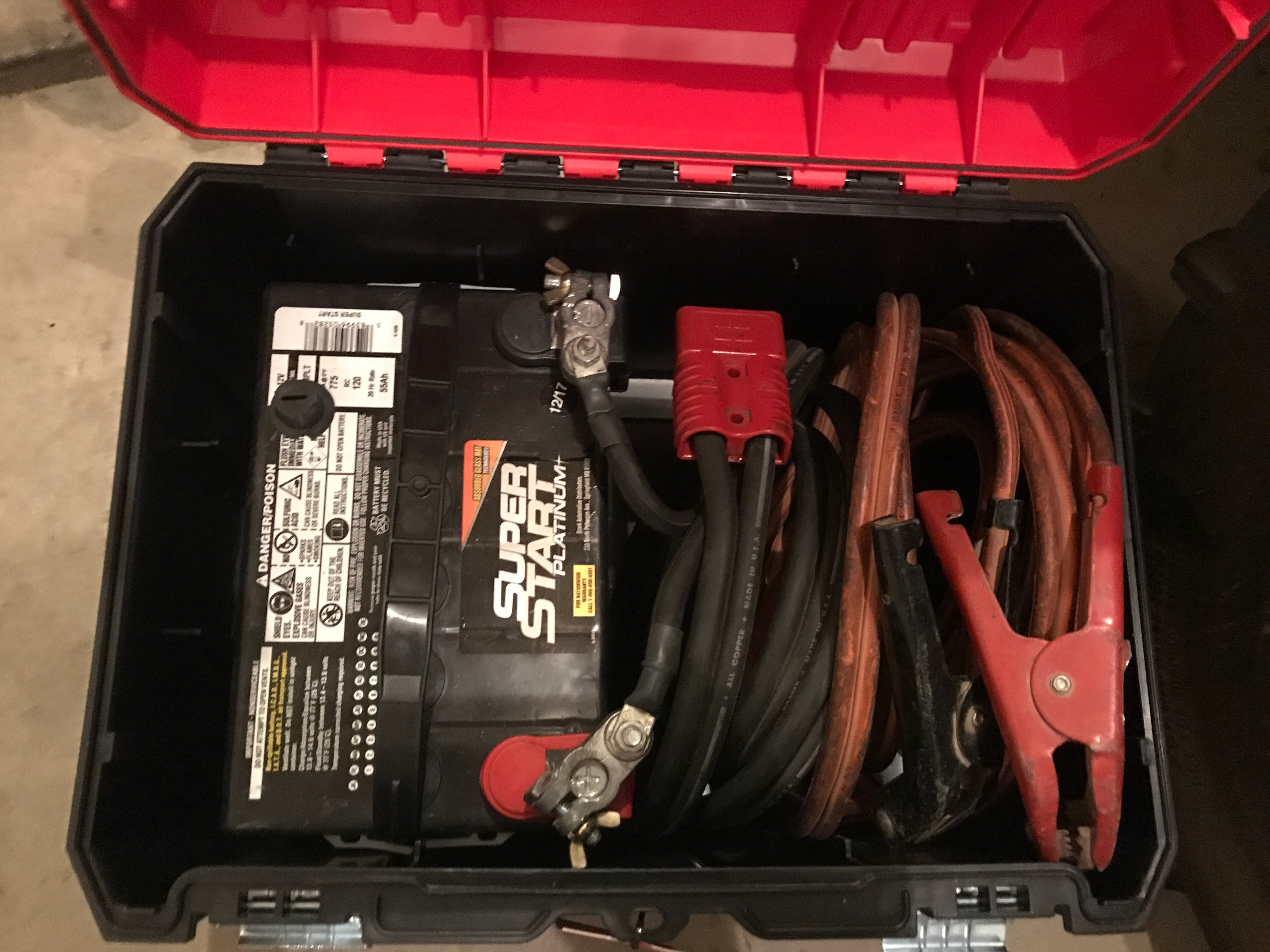

Post by ramv » Mon Jan 21, 2019 9:29 pm
Starting off with this jump pack. Might do a charge circuit off the trailer charge circuit to "trickle charge" Can plug into the two gauge for more rapid or throw the 120 v charger on it at the house.
