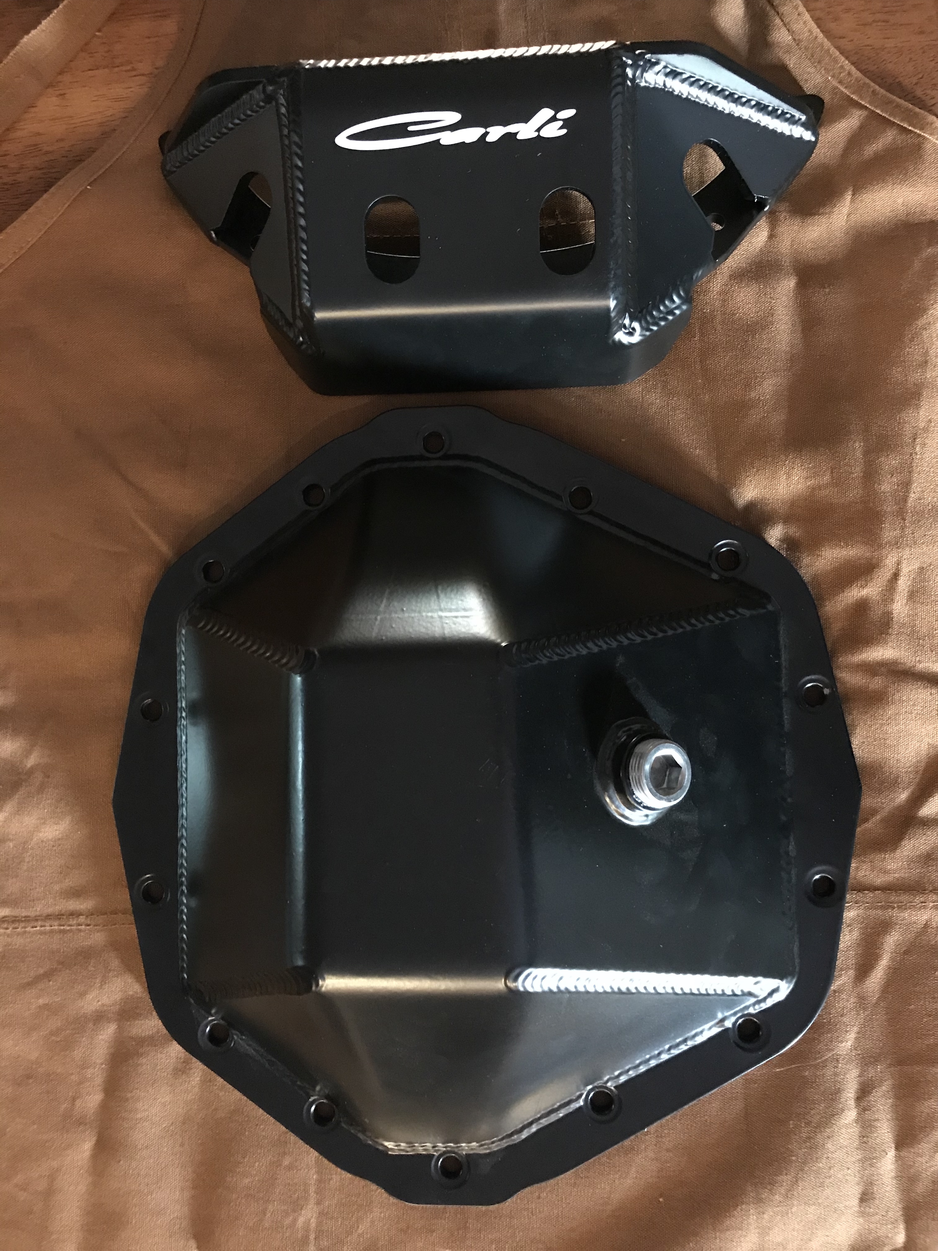

Carli front, RuffStuff AAM 11.5
I picked up a Carli and got the RuffStuff rear cover back from the powdercoaters today. I had to order what was available to me and in AK the shipping options are limited! Should work out well, hopefully.

Nice!! I really dig the Carli units. I haven’t played with the Ruff Stuffs but they look solid! I don’t think Gale Banks will be crawling under your truck any time soon to disrupt your oil flow.
