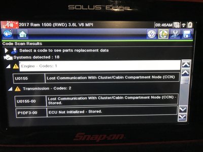

Tested and confirmed: If you want your instrument cluster to go dark on a 2013 - 2019 PW, remove fuses #49 & 88 together.
Be aware that doing this will set code #U0155 in multiple modules, but it does not cause the check engine light to come on.
