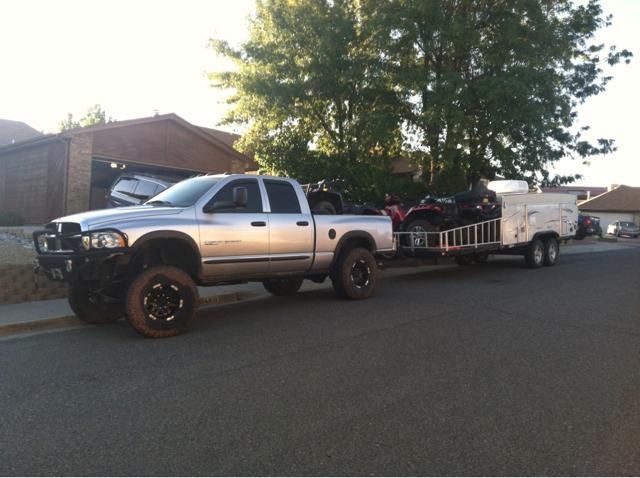

Perfect timing on this thread. I am also in need of a brake controller and some sort of helper for my rear end also. With my new to me popup camper, it's time for both. The popup only weighs about 5k lbs, but completely loaded with gear, water, supplies, 2 quads, etc, plus the bed of the truck loaded with another quad, dirt bike and more supplies, I'm pushing the 8,000-8,500 lb mark, with a lot of the load on the rear end. My leaves have really softened up lately also. I think the last 7 years of abuse is starting to take its toll.
Here's a pick with just the empty popup. It's a little hard to tell with the angle of the road, but even empty, it's squatting pretty good.
This is loaded up. Again, the road makes it look far less squatted than it actually is.
I'm going to get me a stabilizing hitch and brake controller first, then look at possible Timbrens or Carli LT bags. I've heard good and bad about the Carli bags, but I'm very unsure of how well they would hold up to my abuse. Also probably have to get me a set of Carli leaves soon.

Another concern I would have, with using a stabilizing hitch, would be offroad ability. I'm figuring with a stabilizer hitch, it could cause some issues if the road less traveled begins to get a little rough. I'm picturing bending frames, hitches or busting stabilizer chains. :shock: I'm I correct in this logic, as I have never used one before?

You definitely have a hefty load there! What kind of brakes are on the trailer? Electric or Electric over Hydraulic? I know the Tenkosha P3 I just ordered allows you to choose either trailer brake configuration on the screen. I also got it fairly priced off Amazon (around $130). Carli bags are sweet but the $1200 price tag is not. Also I'm not sure if your truck would exceed the maximum travel amount of the Carli bags. How much is your back end lifted over stock? The Carli's are rated for 12" of suspension travel...I'd consider getting a pair of the Timbren helper springs that I ordered. I don't tow all the time, but when I do, I'll remove my factory bumpstops, bolt up the Timbrens and tow. When I'm done, unbolt them and bolt the bumpstop back up. They won't ride as good as airbags but they'll handle the load and they're a BUNCH cheaper! Do you have a bumpstop spacer? If possible you might use that in conjunction with the Timbrens. FWIW I got mine shipped for around $170 from Amazon as well today...

The trailer's got electric brakes. My back end has 3" blocks under the stock leaves. I do need to bring it up just a little more, to level it out though. I don't care for the pre-runner look rear rake I've got going on right now. When I lifted the truck 6 years ago (5" front, 3" rear), it sat almost perfectly level. In that time, the rear end has definitely sagged. After swapping out the spacers for the Thuren coils, it's definitely more noticeable. I also do have bump stop spacers in the rear.
