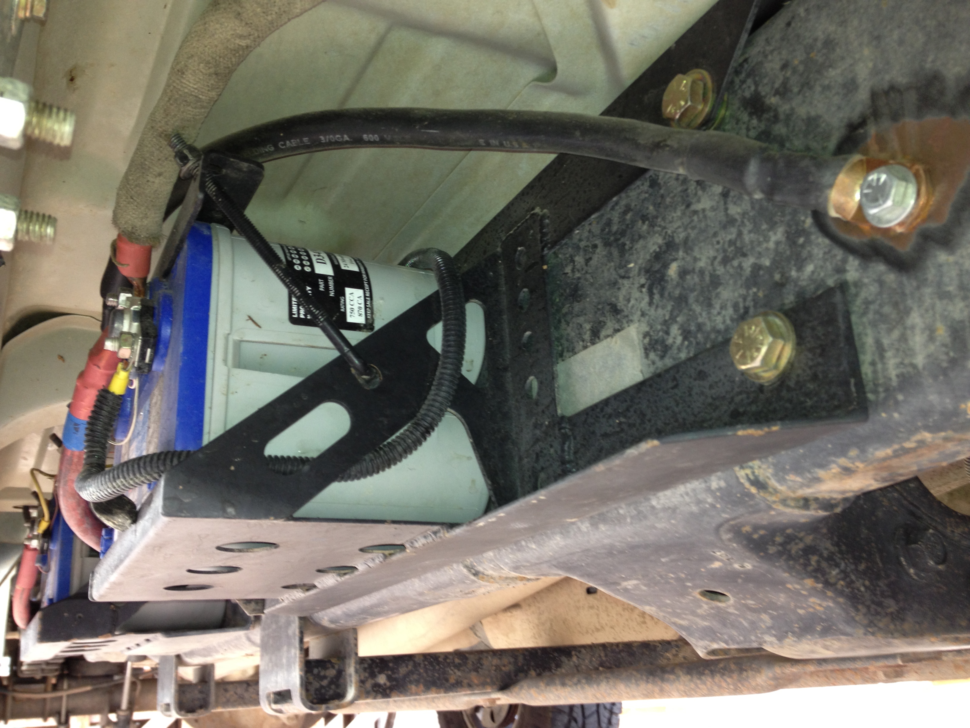

There is a lot of room for batteries under the cab on my 3G. Two Optima Grp 34s mounted on their sides, bolted to the frame rail, tucked way up and out of the way. Controlled thru a Painless Performance solenoid/isolator, plus a Blue Seas rotary switch so that I can use one, two, or all three batteries simultaneously, or hold one in reserve while winching. Battery boxes are from Summit Racing, with some mods to strengthen them and facilitate installation.

That is an impressive setup! Is the third main battery an Optima Grp 34s also? Aren't the batteries supposed to be in matched pairs or trios?

Starting battery is an Odyssey Grp 31 Extreme Marine. Alternator is 270 amp and cables are 3/0 welding cable. It's a good idea to match all batteries if they are not isolated when the truck is not running, but not necessary if they are isolated. Mine are all AGM with similar chemistry and similar (but not identical) charging profiles. My solenoid can isolate the batteries when the truck is running, or combine them when running, or isolate/combine when the truck is shut off. I can put one or two or all three into the starting or winching circuit, and can cut one or two or all three out of the charging circuit, depending on how I set the switches. Nothing is automatic, all done with one toggle on the dash and one rotary switch under the back seat. My Indel B fridge lives on the back seat platform, and I have a double National Luna battery monitor back there, with a single monitor on the dash for the Odyssey. When this Odyssey dies, I will probably replace it with a Northstar 31, and Northstar 34s when the Optimas expire. All batteries are about 2-1/2 years old now. Planning to add a 100W solar panel to keep the Odyssey happy when truck sits for long periods, but have not yet decided what to use for the solar controller. If I were doing this again from scratch, I'd try to stuff in bigger batteries than the Grp 34s, but they made sense at the time because I had three other trucks all running Grp 34s or 34/78s, so I always had those batteries around.

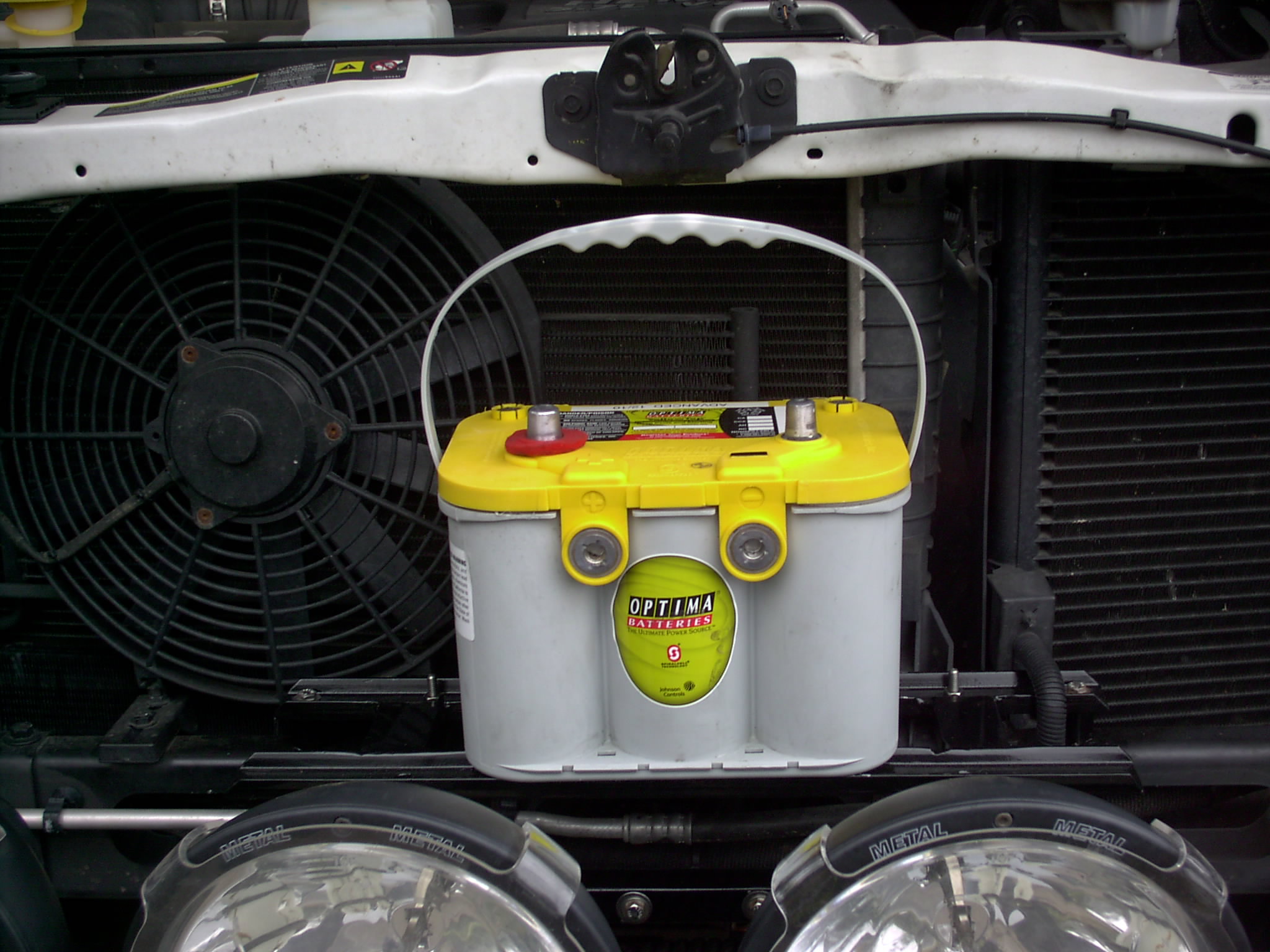

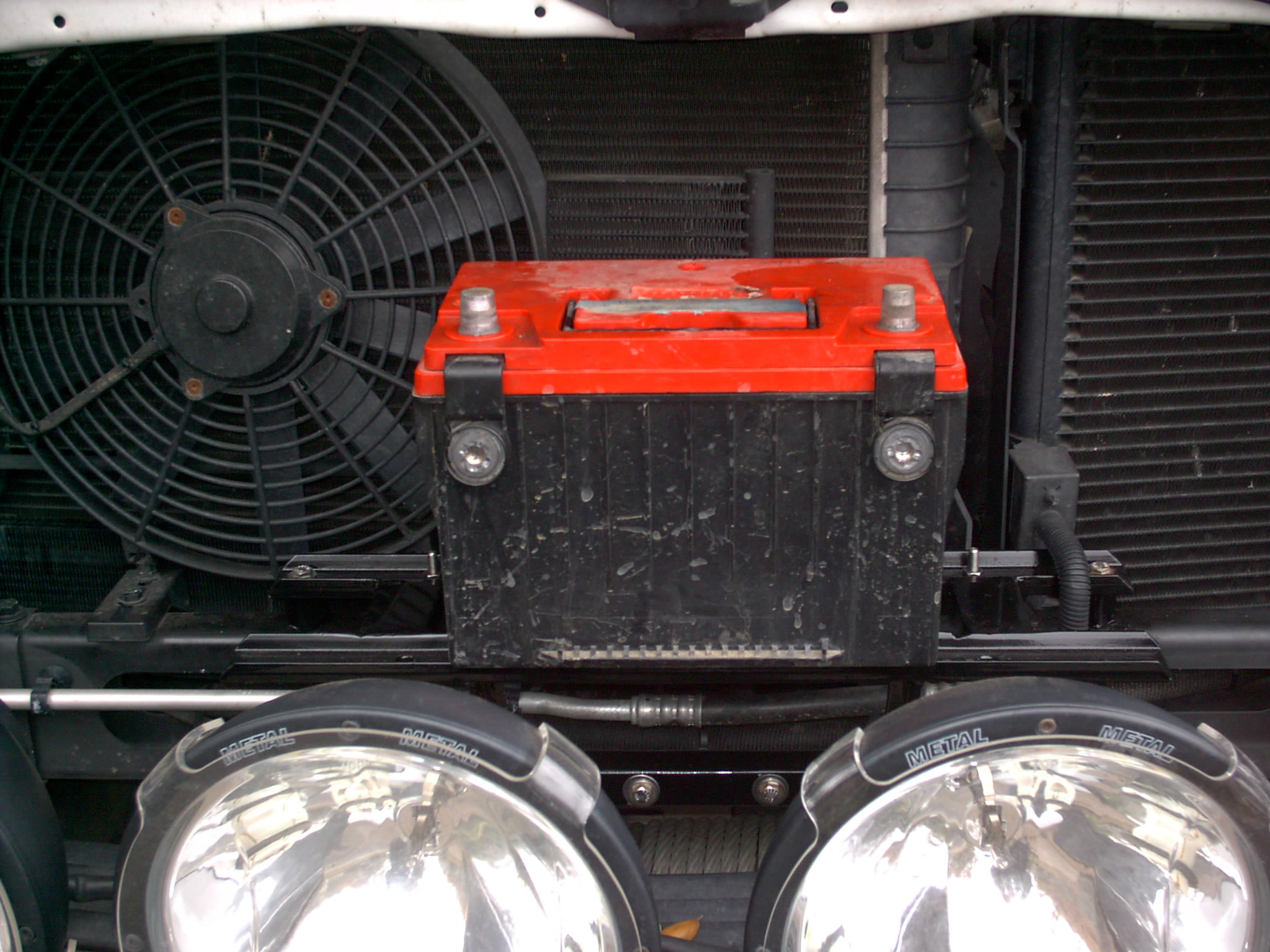

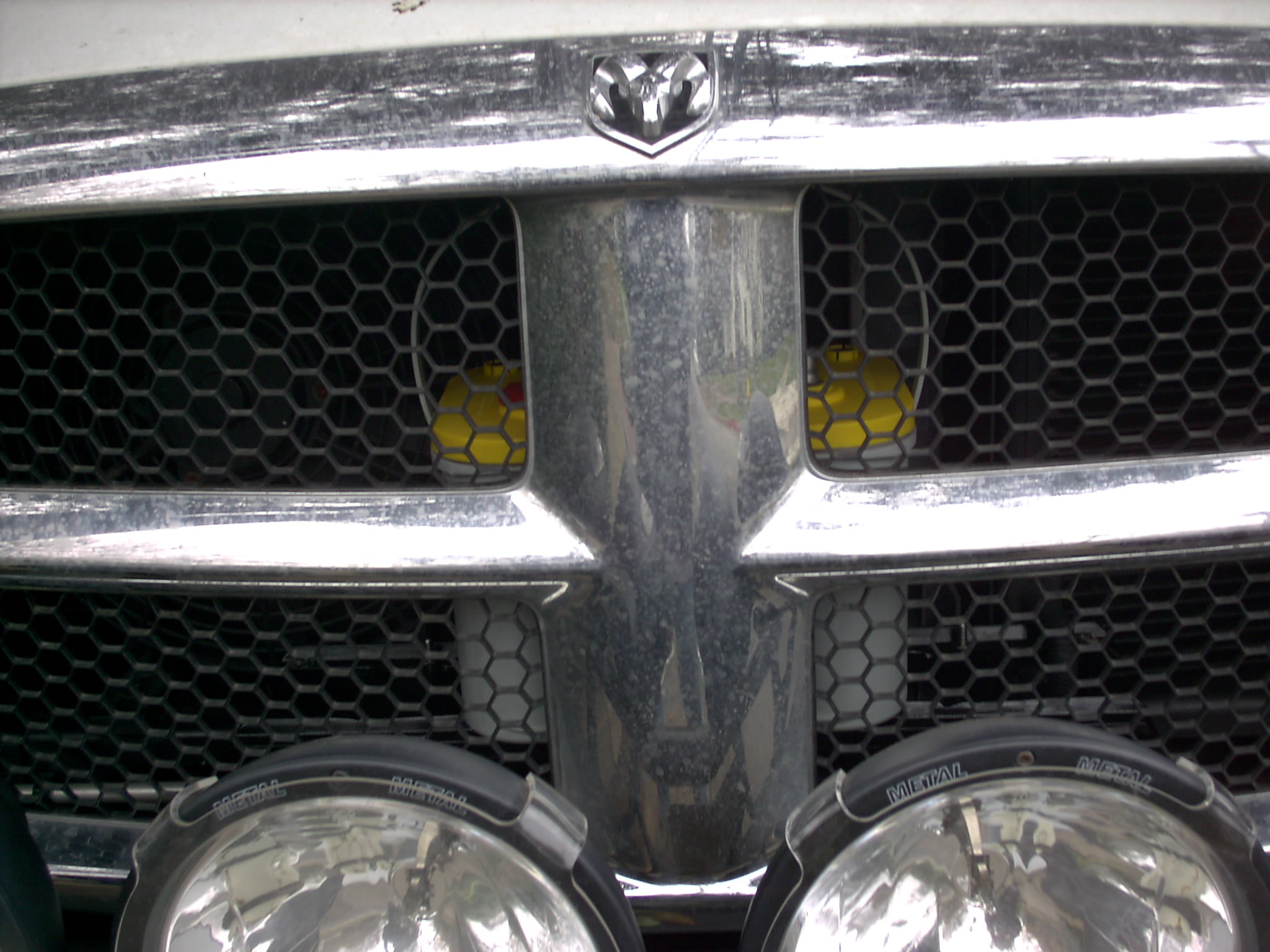

To OP, my 3G has plenty of room between the radiator and the grill to mount a pair of Grp 34s. When I was fabbing the cradle for my air compressor in that location, I did a test fit with a couple of Optima 34s on the cradle to to be sure they would fit if I ever needed to do that. Took pics with one battery there, but two definitely fit, no interference with the grill or hood mechanism. Probably similar or more space in a 4G, but you'll have to pull the grill to do the install. The last pic shows the Warn compressor after installation on that cradle.

Thanks. Grill area looks tighter on 4G. Hesitant on air flow blocking too...
Air flow is not a problem, at least on mine. That Warn compressor is bigger than a pair of Grp 34 batteries and my truck spends most of its fun time in the AZ desert in summer and fall, with ambients up to 128F and lots of slow running on dirt roads. Truck cooling system runs at 206F all year around and has never gone above 210F, even in the summer. You'll notice an electric aux fan on the passenger side, to the left of the pics. That is switched separately from the dash, and the only times I have used it were long periods of idling in hot weather.
