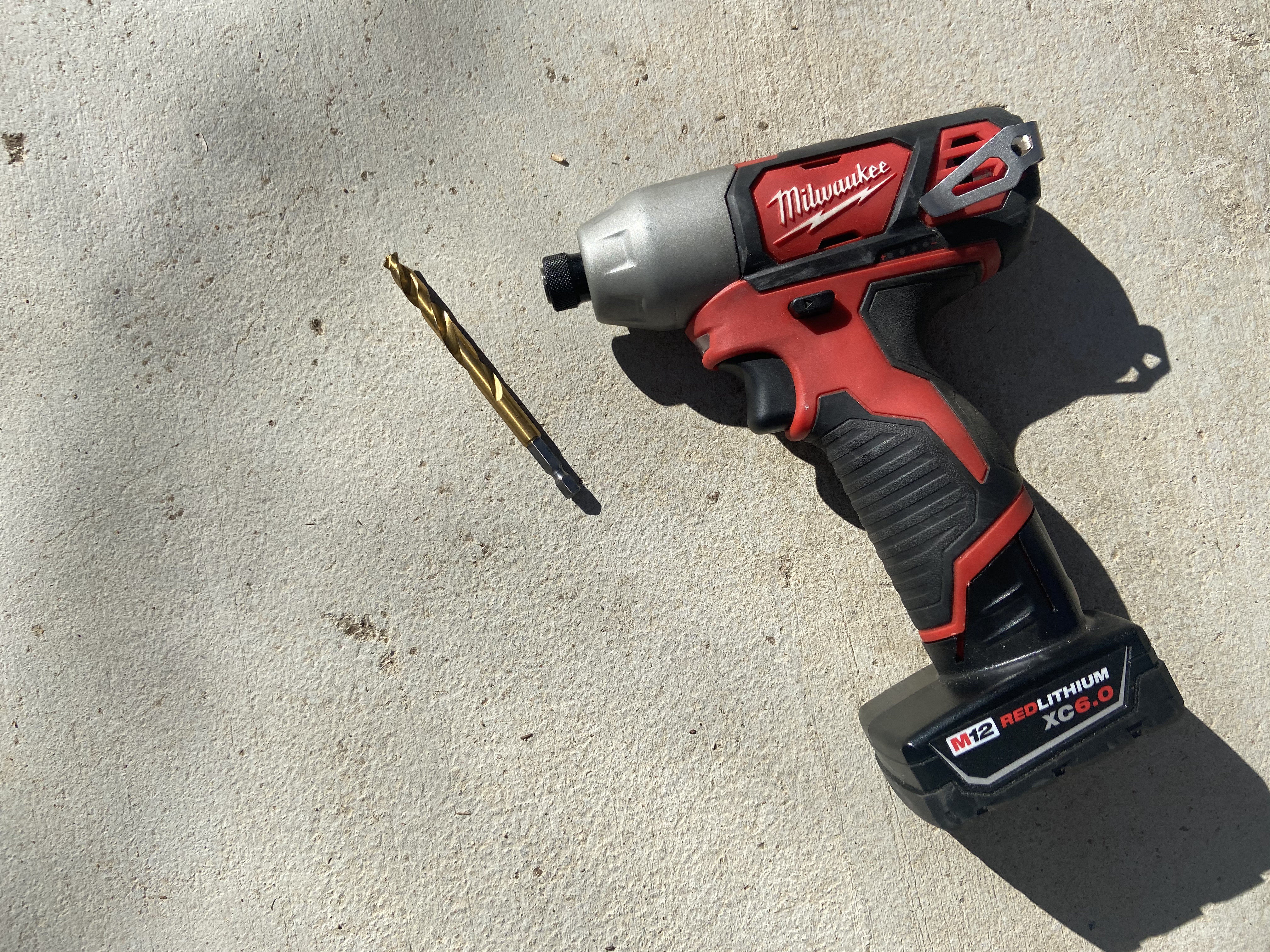

I finally got my 5000 Ultimate air bags and Daystar cradles installed. Life and procrastination have been getting in the way.
Everything was very straightforward. I really didn't want to mess with the lower shock bolts so I had planned on using a 90deg offset drill chuck that has sat unused in my toolbox for about 25 years. I removed the chuck from my old corded drill without issue and then realized there was no way put a 3/8" chuck on a drill that uses a 1/2" one. :oops: The chucks would not budge from my 3/8" Dewalt or Milwaukee drills.
While I was looking at my collection of power tools, I realized my little 12v Milwaukee impact driver might be the solution. Sure enough, I found a 5/16" drill bit for impact drivers problem solved with room to spare.
The only other deviation from the previous posts was my placement of the fill valves. I used the upper holes in my rear license plate. I stole the idea from pictures on line.
