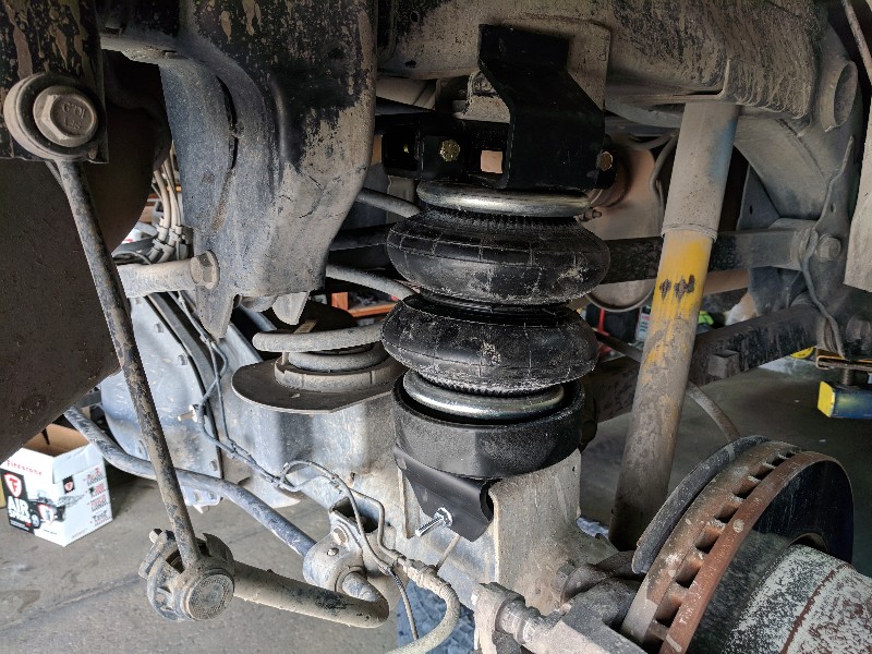

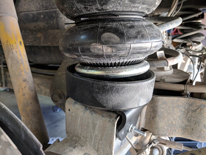

Installed bags, cradles, and on board air today. Pretty straight forward. I used the lower brackets that came with my bags because that seemed like way less of a headache than threading a custom hole and the brackets are less than 1/2 inch thick. Bags need 5 psi minimum. They rest in cradles at normal ride weight but will separate when rear axle goes full droop. Only custom mod was a slightly longer tapered head bolt going from lower bracket to the day stars. Had to grind a bit of the bolt off, but the bags seat in the tapered part of the cradles and don't ever actually rest on the bottom.

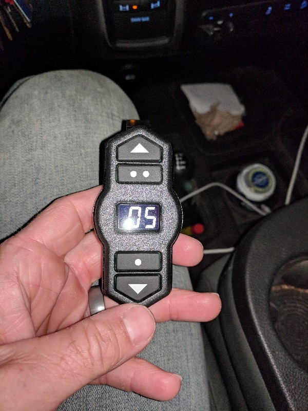

Went with a wireless one compressor with remote.

I wouldn't have done bags without it. I often haul heavy bed loads relatively short distances; the inconvenience of locating a compressor or hooking up my portable one would have kept me from using them. It has 3 presets and won't let you deflate any lower than 5 psi. Airing up/down literally at the press of a button. Compressor install is super easy as well.

Didn't mean to cause confusion; it is a remote system. But no wires. Tuck it away and only get it out when you need it. It is backlit but my flash is washing it out. Also has a thingy on the back like a garage door opener. Auto sleeps when not in use.
