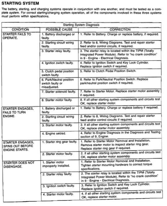

Disconnect the battery and short out the plus and minus cables together. Leave it like that for more than 5 minutes. While it is shorted, cycle the key to the on and start position then off. Reconnect the battery and try to start it again.
- Posts: 1214
Re: Not turning over
Take a test light or voltmeter so you can test for battery power and crank signal to the starter.
- Do you have any kind of aftermarket alarm system on the truck?
- Is it the same key you always use?
- Do you have a scanner to check for trouble codes?
- Is there any corrosion on your battery cables?
- Be sure your battery is fully charged: It only takes 30-50 amps to power everything up when you turn the key on, but it takes 200-300 amps to crank the starter over.
- With the starter installed and connected, if you touch a jumper wire from the large battery cable post to the small signal wire terminal, it should crank over.

It's honestly good that it won't start and not an intermittent issue. All you need is a test light and a helper to turn the key. If the test light illuminates on the small terminal when cranking and the battery is good you need a starter. If not, I would suspect a bad WCM (ignition switch) which has to be dealer programmed. This same thing happened to me a while back and ended up being the wcm. Also if you have remote start it will usually remote start even with a bad wcm. I've also seen a few bad "S" terminal connectors cause the same issue. Good luck and let everyone know what you find.
Just checked....I have 12V going to starter trigger. Which means it has to be the starter correct???
- Posts: 1214
Yes. Probably a bad connection inside the starter and when you remove it to bench test it, things get shaken around and it tests good, but in the rig it fails.drdfblackm wrote: ↑Wed Oct 11, 2017 3:34 pmJust checked....I have 12V going to starter trigger. Which means it has to be the starter correct???
