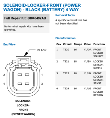

I started by doing simple bench tests to check for continuity and resistance.
Rear Locker Connector for an 05 PW (your wire colors may vary).
On both the old actuator and the good one that I tested on my truck, the results were the same: When I tested resistance on pins #1 & 4 they both read 1.7 -1.9 ohms. When I applied 12V power and ground to pins #1 & 4 the electro magnet energized and created a magnetic field. Testing the sensor wires (pins #2 & 3) is where it gets weird. On both of them the resistance was 6+ mega ohms and had no significant change when the locker was engaged or disengaged. Pin #2 is a 5V reference voltage from the FDCM/SmartBar into the sensor and pin #3 is the modified voltage returning to the SmartBar based on sensor input. When I measured voltage on pin #3, it was 0.6V when unlocked and 1.4V when locked. The only thing that I didn't do was to apply heat to the old actuator to see if it caused any changes to the readings. However I can tell you that when the electro magnet is energized, after 5+ minutes, it gets almost too warm to touch (130-140º). The way that I tested the "lock/unlock" ability of the old actuator was to plug it into my truck and apply a neodymium magnet to the sensor and read the results on my scanner. Also, the sensor is polarity sensitive to the magnet. Apply the magnet one way and nothing happens, flip the magnet over to the other pole and then you get results.
Hey BLM do you have the same pic of the front locker plug?

Posted: Fri Oct 02, 2020 2:03 am
by Retired BLM Rig
stamm20 wrote:
Thu Oct 01, 2020 7:30 pm
Retired BLM Rig wrote:
Mon Apr 02, 2018 3:09 am
So I'm the recipient of Flattire's old locker actuator and I finally had some time to do some testing. I wanted to document my findings here in the hopes that someone else dealing with a flashing locker light in the future would have a baseline of information to deal with that might help lead to a more accurate diagnosis. The odd thing is, that in the process of testing, my own rear locker light started flashing and setting a code in the final drive control module (FDCM). I was beginning to suspect that the problem was contagious and that my truck had contracted the disease.
Keep in mind that Flattire's truck is an 2005, which is a pre-CAN computer system, so there is no way to read FDCM data on his truck with a scanner. This makes the situation much more difficult when it comes to diagnosing electronic problems, you have to resort to back probing harnesses with a multimeter to get data and once you have that data there's a drought of information to help you figure out what it means.
Here's the website that has all the images for connectors, pin positions and wire colors for Chrysler, Jeep, Dodge and Ram. You just have to be patient in your searching: https://connectorrepairkit.mopar.com
For your year, the layout/pin position is the same as the rear locker plug, just the circuit numbers and wire colors are different. Here's the front locker plug:
2007 Front Locker Connector
