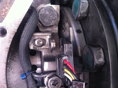

I started getting the flashing rear locker and while the diff fluid had been changed at Chrysler a couple years back, I was pretty sure they didn't clean the magnets. So I decided to tear into it today and check it out. As I suspected the rear locker magnet was a big ball of particles suspended in gooey diff fluid. Did a quick little video here: http://powerwagonregistry.org/temp/IMG_1143.MOV

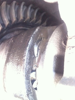

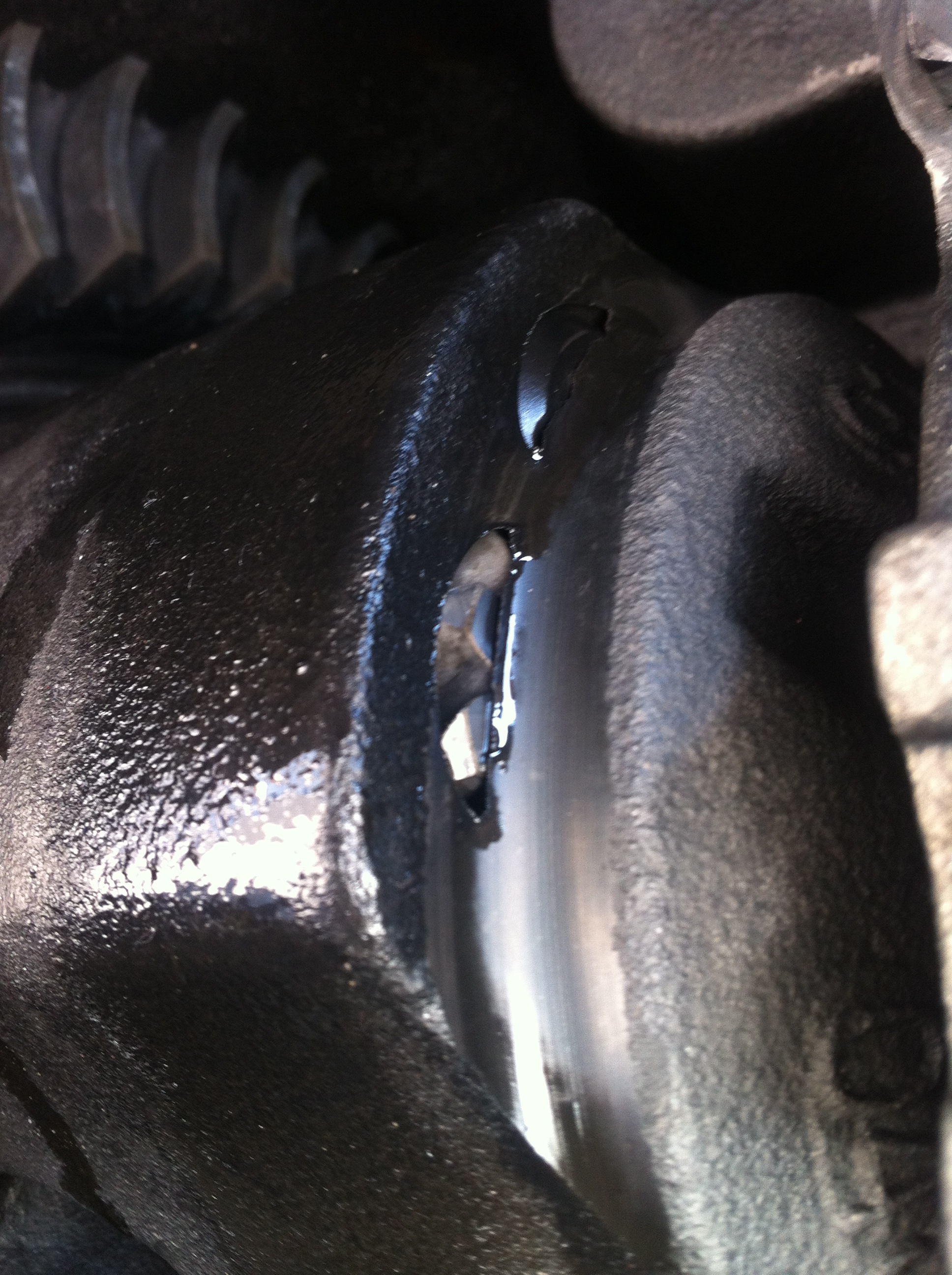

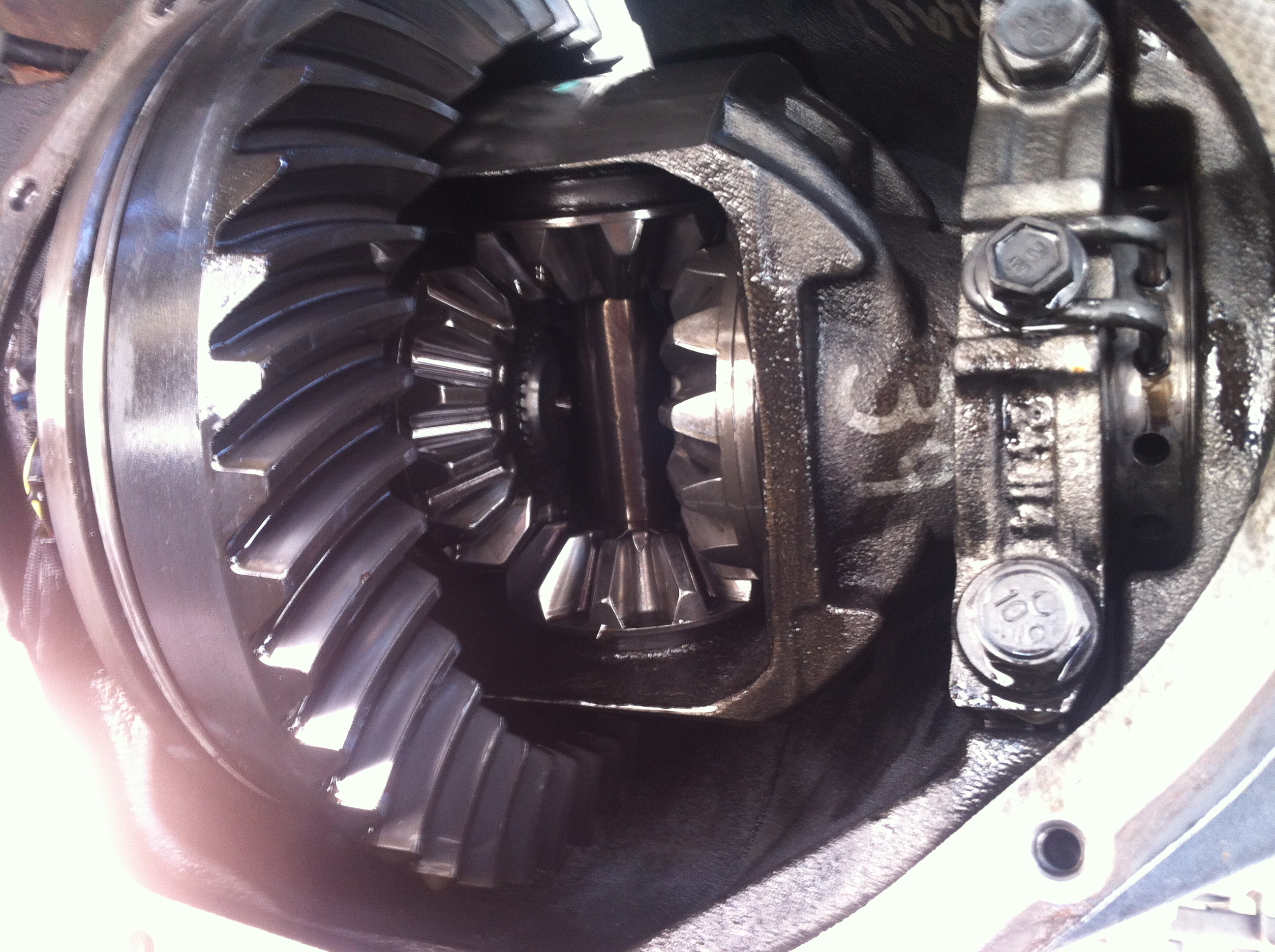

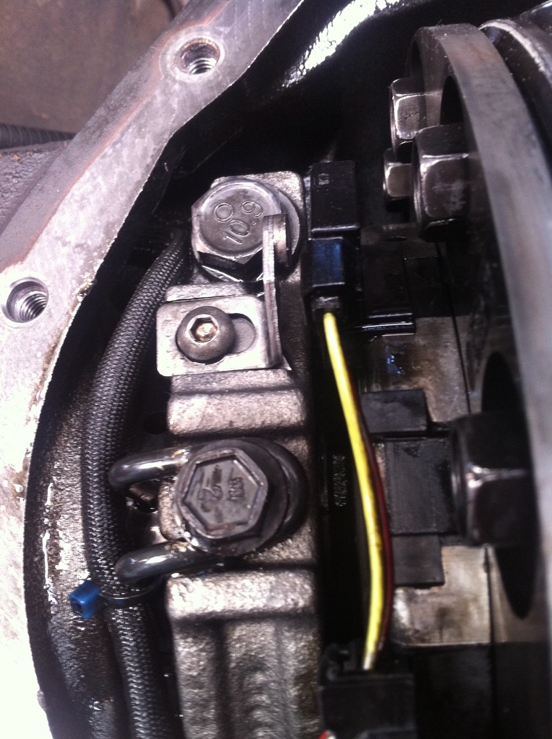

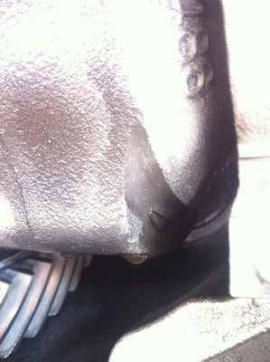

Cleaned it all up and then did the front which was in much better condition. One quick question to those of you who have been digging around in there... Pics 3, 4, 5 are of the rear diff and it looks like the gears are eating their way through the housing. Just doesn't seem right to me.

Pics 3, 4, and 5 are normal machine clearances from the factory when they did the manufacturing of the diff. They don't debur the housing when they finished the assembly, it's not needed because it's contained within. It is not a wear through, most if not all the e-locker 10.5" AAM diffs look like this new.

2X on what Chris said. Also those cuts are there for fluid flow throw the carrier.

Mine has them also. I thought the same thing------- WTF !!! Keep your pics so you can compare them down the road. Thats the only way to tell if they get worse.
