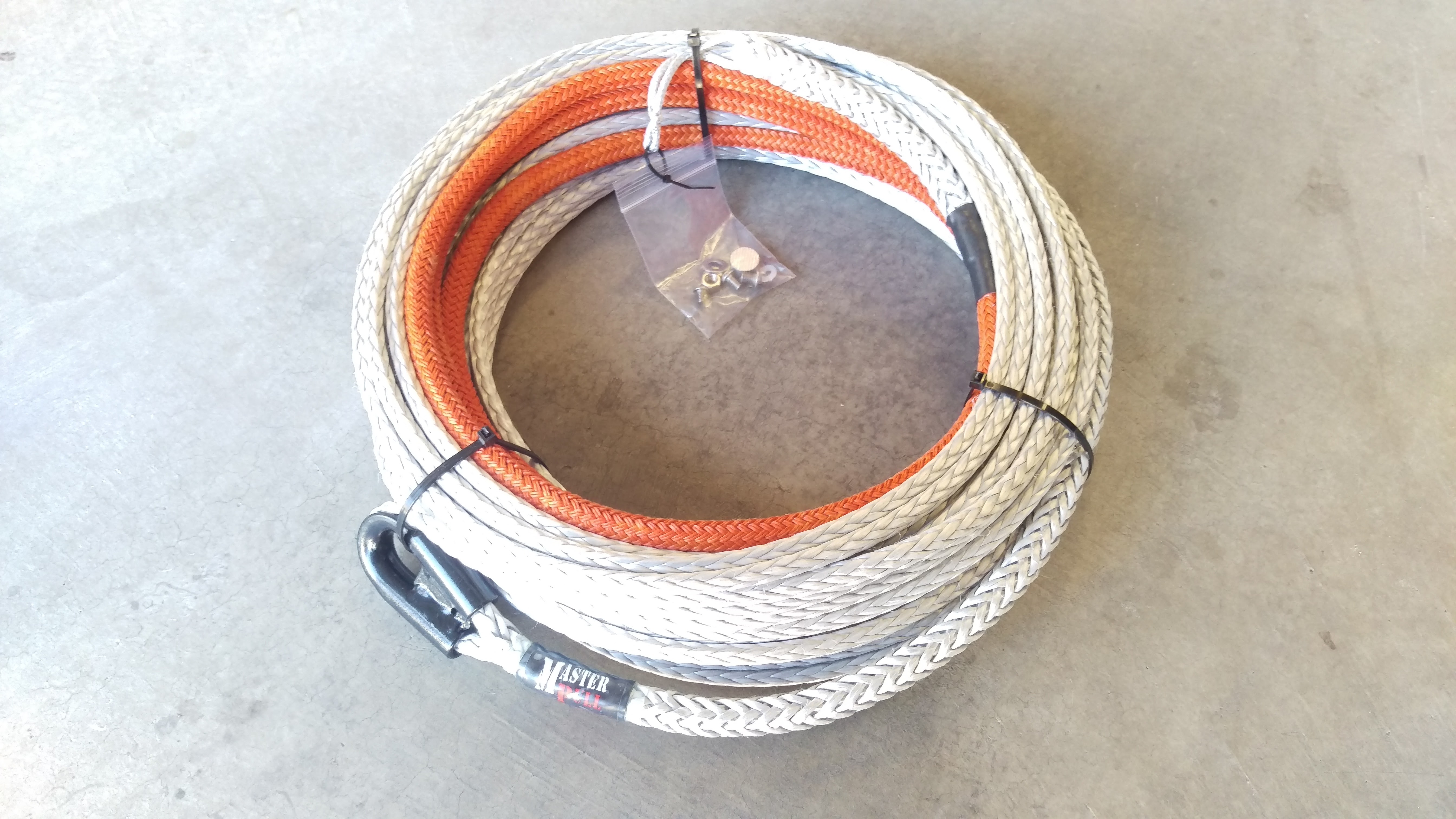

This past February I replaced my steel cable with some Master Pull synthetic. I have the 3/8" line, rated at 29,700 lbs. I've used it to pull vehicles, move fallen trees and other fun stuff (zip line for the kids).

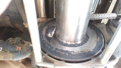

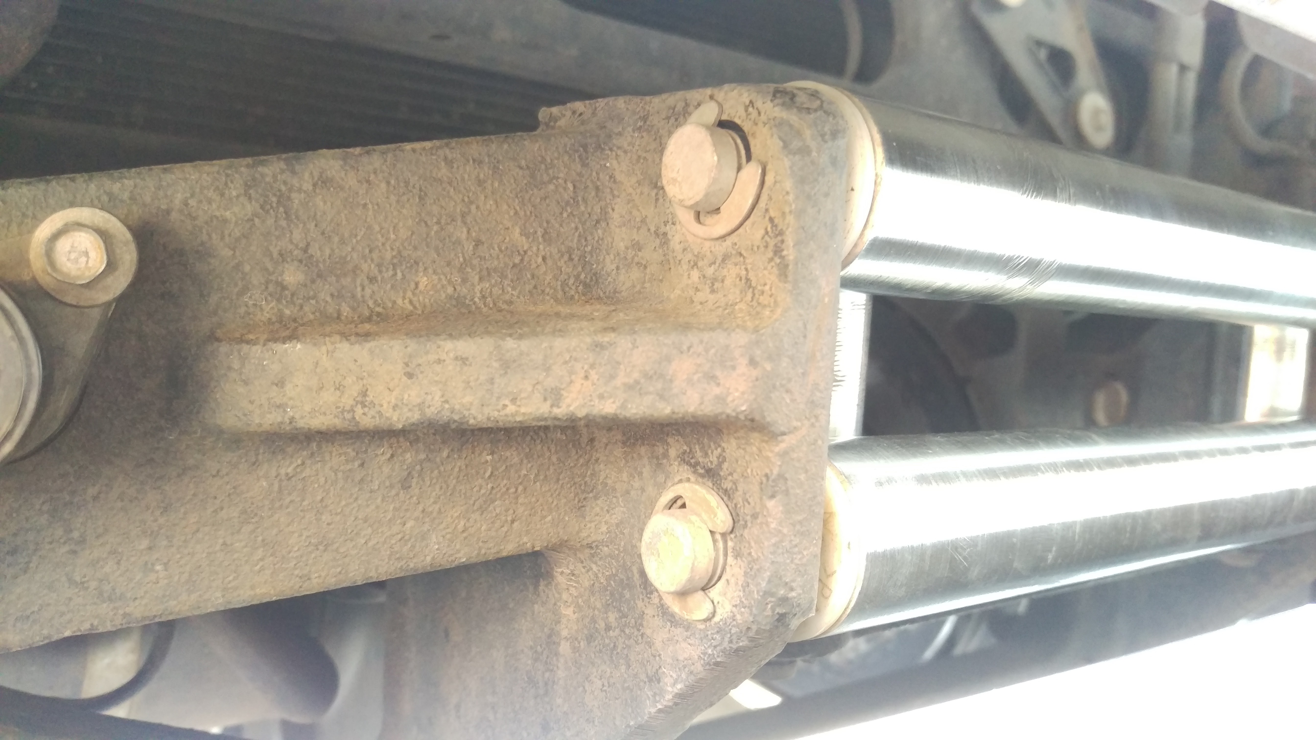

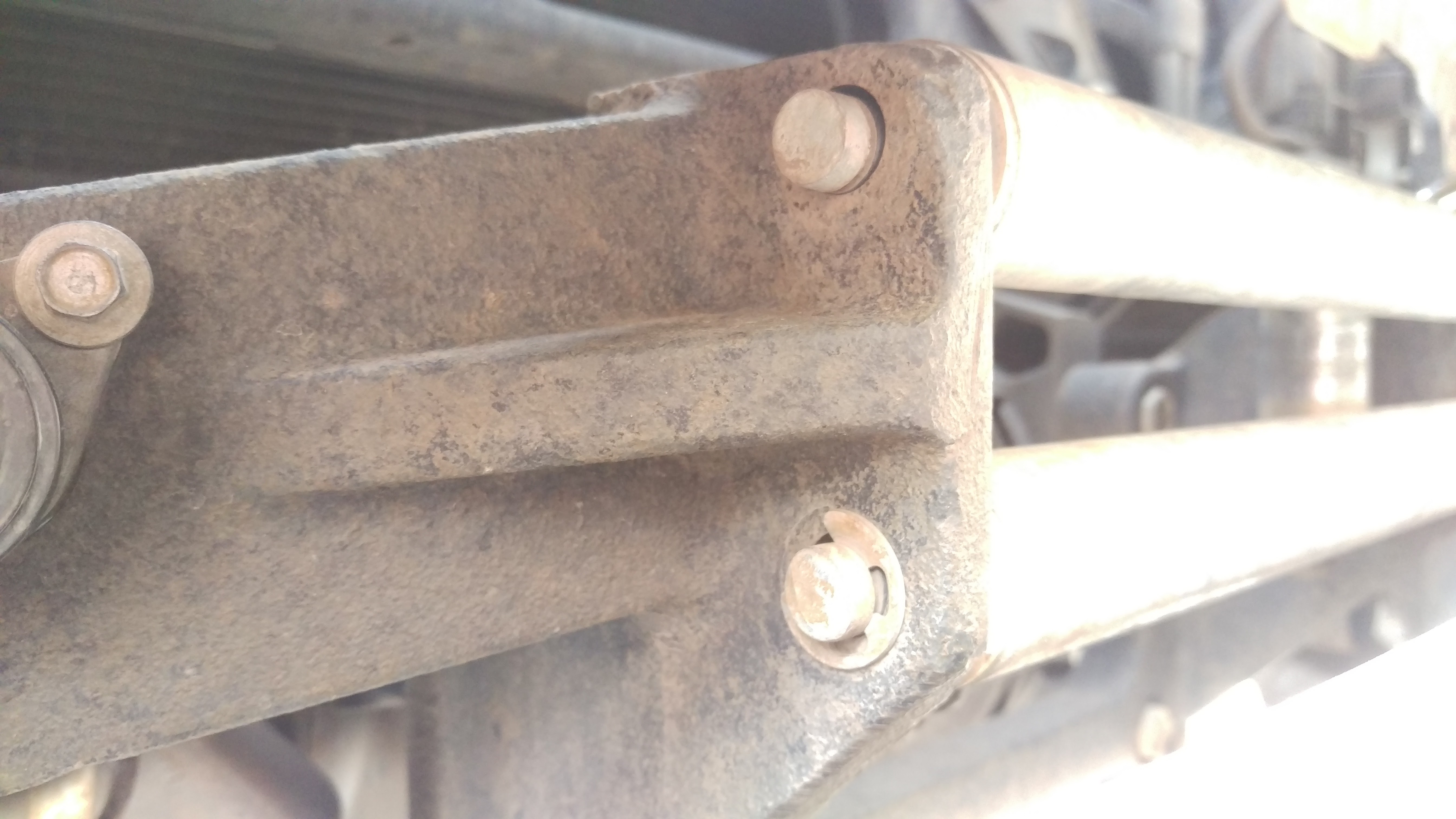

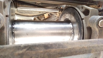

After removing the old cable, remove all 4 rollers and sand them down smooth. Super smooth. I used a drill with the roller mounted on the end, working up to 1000 grit sand paper.

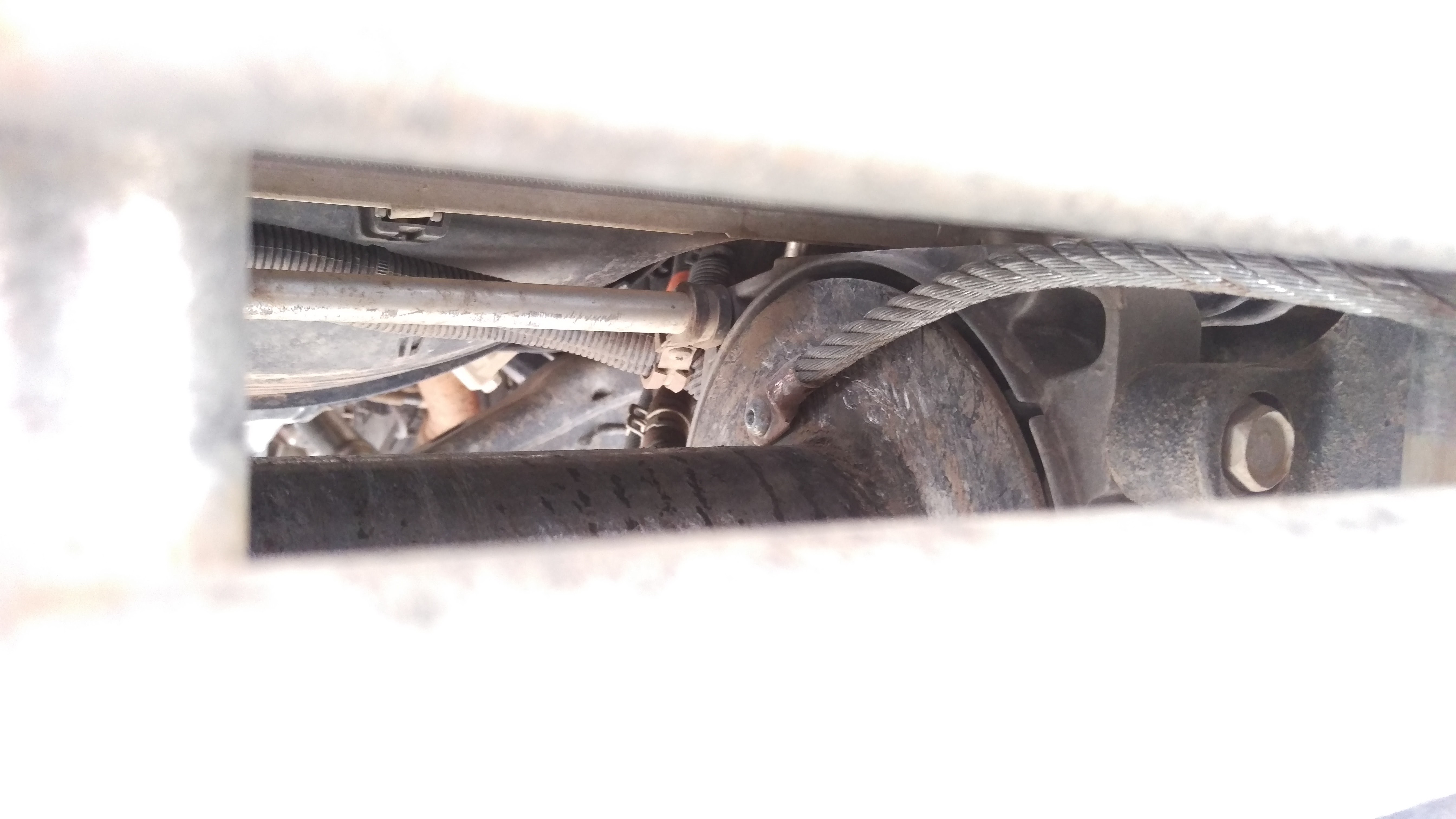

Once the rollers are off and sanded, sand down the winch drum. Again, super smooth. make sure there is nothing sharp on the drum. I ran my fingers over the entire drum to make sure. If t felt rough, I sanded or used a super fine file. My drum was relatively smooth, just needed to smooth down some of the welding burs/bumps.

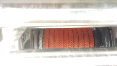

Once everything is super smooth, mount the rollers back on, and then mount the end of the winch line to the drum. Master Pull lines come with the drum end beefed up.
Spool the line on and that's it. Super simple install.

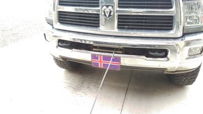

As for people who say the line has gotten caught in the rollers, if you look at the rollers on the PW, the horizontal rollers are in front of the vertical ones. This is opposite of most roller fairleads I see on Jeeps and such. I've pulled some extreme pulls and had no issues. I don't think there is a way for the line to get caught in the configuration the PW has the rollers in.
I've pulled the full weight of my truck up hill roughly 45 degree angle in 1 foot of mud, no issues. You just have to make sure your synthetic line is protected where ever it touches the ground, goes over a rock or log/tree. Just need to be a bit more aware of you line than you do cable. And look over your rollers from time to time to make sure they are still good to go.
