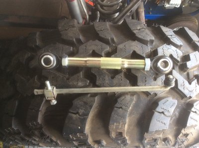

I'm replacing a part that has failed on me twice with parts I've pieced together out of summit racings catalogue. Any idea what this is for?

Looks a bit like one of the rear swaybar links on my 16. Only thing I can think of offhand.

Excellent guess, but no. I should have mentioned it's a 3G so no rear sway bar.

Transfercase linkage?

Give the man a cigar! Yes sir, the crappy rubber bushing has died on me for the last time. Installing this today.

It's super easy to piece together damagewagon, I'll list the part numbers so people can put one together themselves if they'd like.
From summit racing
1 AFC-36176 threaded tube
1 SUM-MAXL10T left hand thread rod end w/ jam nut
1 SUM-MAX10T right hand thread rod end w/jam nut
2 MEZ-SW58A rod end safety washers
2 5/8x2 1/2" grade 8 bolts with nuts and washers from local hardware store
Just got it installed, was a minor pain on mine because of the front driveshaft safety hoop, but pretty easy and only took about 5 minutes. Shifts like BUTTER! No noticeable extra vibrations so far either.
Just antisieze the rod ends thread them in and get its overall length adjusted to match the stocker, then bolt it up. I'm going to get some stover lock nuts and 2-1/2" bolts, local store only had 2" length and it's in need of a bit more thread engagement.

'14+ linkage is 2.5" shorter.

Reloaderguy - they have several longer and shorter swagged tubes of the same design, I would imagine it could be adapted pretty easily for the newer trucks

Hey colibri do you happen to remember what yours measured center to center or end to end, I have 2017 and if indeed it is 2.5 shorter the shortest sleeves summit has are 4". Going to measure my linkage tonight. love the idea and going to try to do before becomes problem. Thanks

The '14+ linkage is approximately 6", about 2.75" shorter than Colibri's. I ordered the 4" tube, hopefully it has the same amount of thread length so I can cut it down. It should be here in a few days.Easttnrhino wrote:Hey colibri do you happen to remember what yours measured center to center or end to end, I have 2017 and if indeed it is 2.5 shorter the shortest sleeves summit has are 4". Going to measure my linkage tonight. love the idea and going to try to do before becomes problem. Thanks
