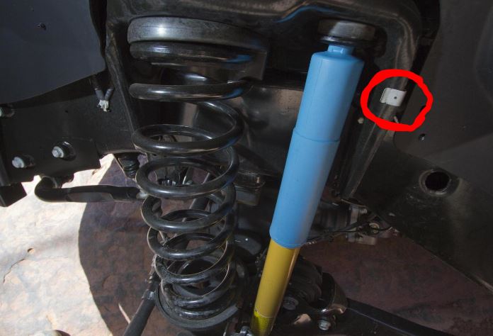

The front axle vent comes off the driver's side of the axle and is clipped to the driver side shock tower. You can reach the end through fender liner. I added on to this line with a 3/8" barbed coupler and 3/8" fuel hose. The original plastic cap fit into the new 3/8" hose with a few wraps of electrical tape on the barb to snug up the fit. I ran this to the same location as Easttnrhino.
