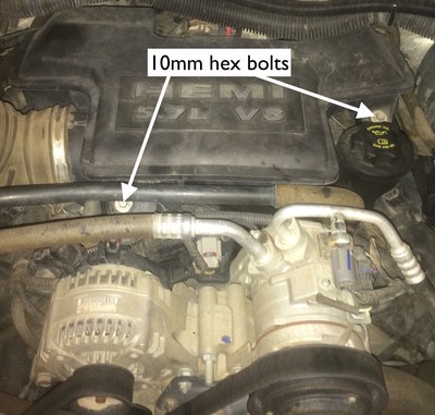

You lift the hood of your 2008 3rd. gen PW and get your bearings and remember that disconnecting the negative battery cable is always the best place to start anytime you're working on anything electrical. Then the air intake is the next thing that has to come off.
You loosen the hose clamp and slip the hose off the air filter box.
Then you look for those two pesky 10mm hex bolts that hold the air intake to the throttle body.
As you begin to lift up on the air intake, you remember to unplug the intake air temperature (IAT) sensor that's right in front.

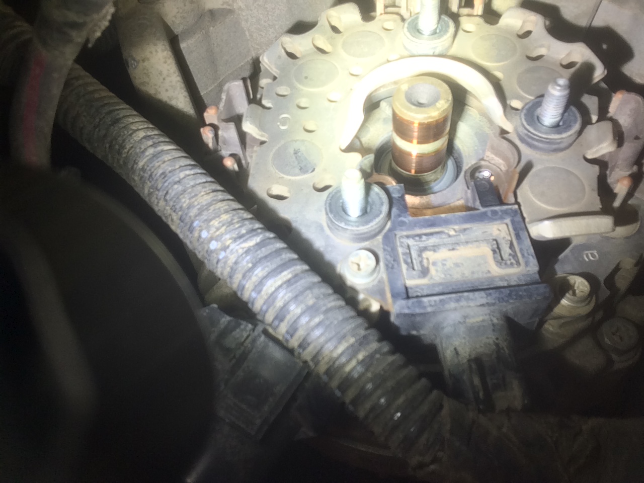

Once all that plastic is out of the way, you can see your goal, the back of the alternator.
You grab your 8mm 1/4" drive socket and assume a seriously compromising position standing on your front bumper leaning over to see the back of the alternator.

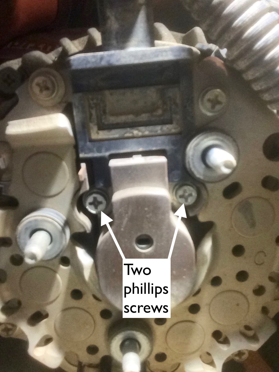

You quickly remove the three 8mm nuts that hold the black plastic shield on the back of the alternator, all the while being oh so careful not to drop those nuts into the abyss that is the engine compartment.
Once that's out of the way it reveals the two phillips screws that mount the brush holder in place. So you take even more care in removing these screws by using a magnet with your screwdriver to make sure they don't get lost.
With the brush holder removed you do a quick inspection of the armature slip rings to make sure they're in good shiny smooth shape and not deeply grooved or burned from arcing caused by poor contact.

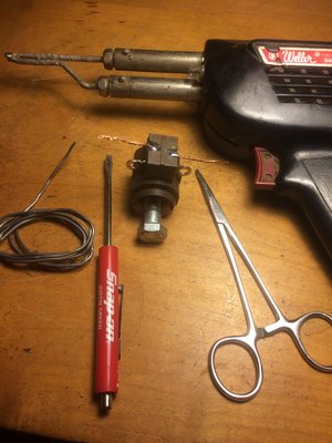

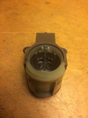

I also bought a set of individual replacement brushes to solder into my O.E. holder so I can still carry a spare.
Brush set #FAX88 $4.99 at Auto Zone.
The bolt just holds the brushes in place until you're done soldering.

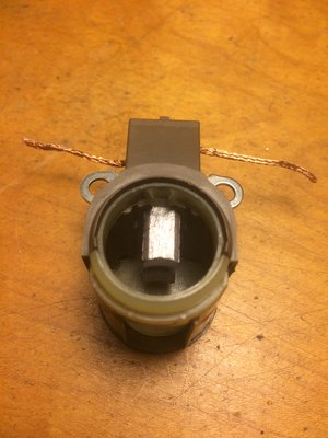

New brushes in O.E. holder, just need to trim the excess wire tails.
Cotter pin slipped in the hole for holding the brushes in place until installation.
The finished product.
