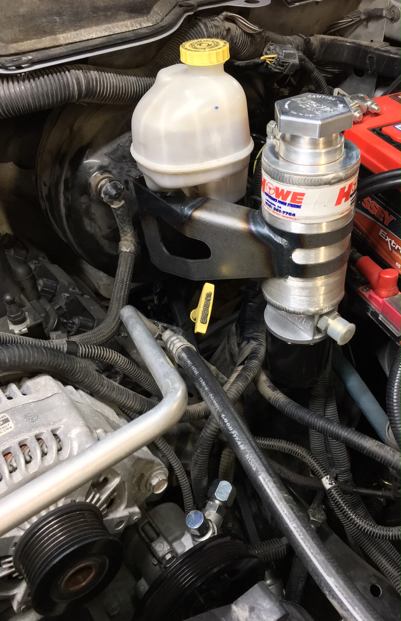

I'm happy to hear all the positive feedback, I haven't gotten to drive mine with the new steering yet. I'll get you some pics of everything, I went with a TC pump and remote filtered reservoir and a mopar big box that had the internal steering stops modified for my trucks lock to lock distance and an 1-1/4" diameter (body) ram that is built to have the lock to lock stroke of my steering. Got everything from Howe Performance Steering. Had the local hydraulic shop make hoses
Brave Motorsports reservoir mount

That remote reservoir setup looks trick! How much more capacity does it have from stock? I might look into setting one up, more fluid volume = better heat dissipation. Been running cool so far but its been quite a bit under freezing point around here lately. Hard rock trail in mid july might be another story tho. Luckily for us our trucks comes with a decent size PS cooler from the factory.
