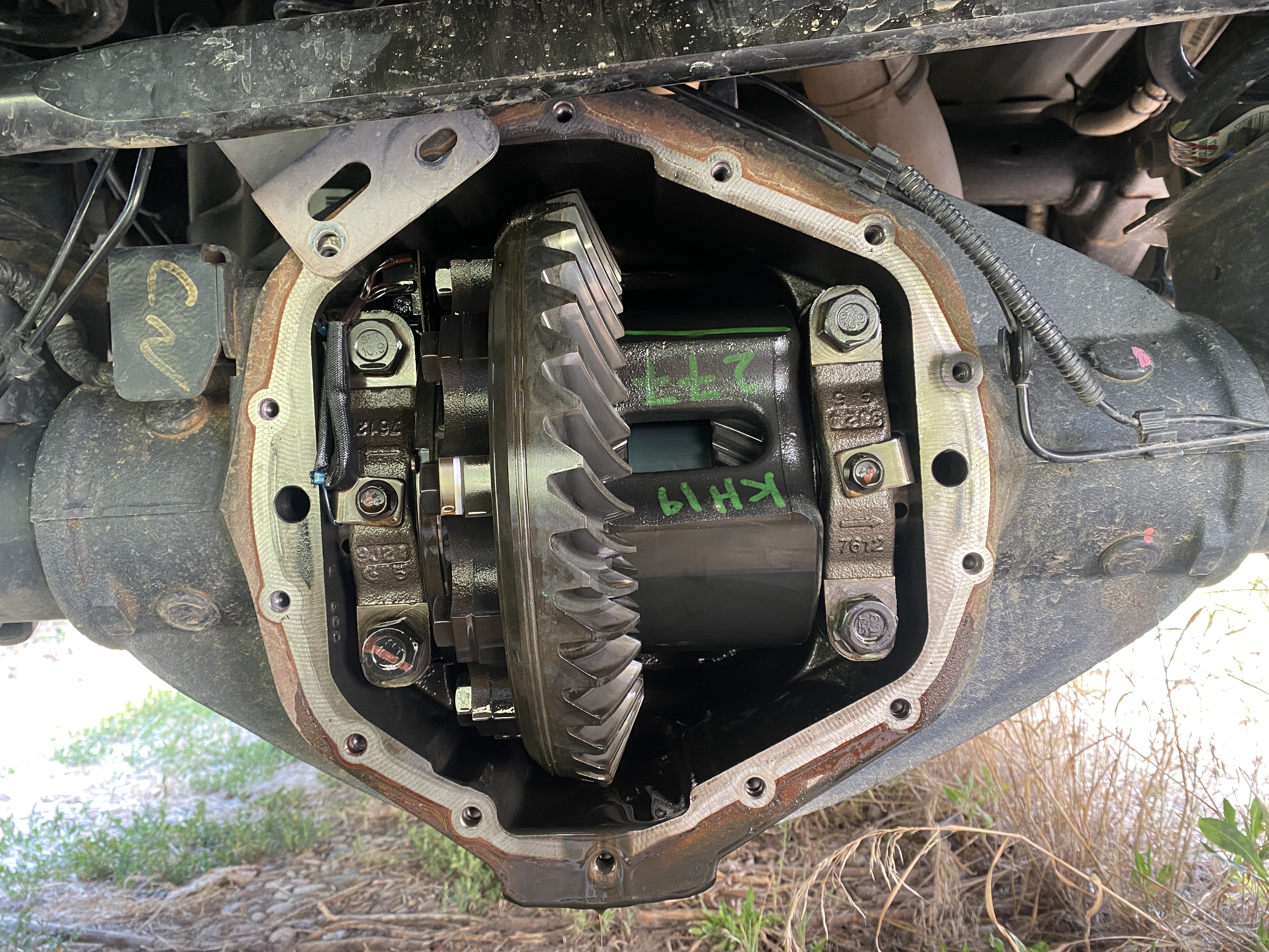

FilterMag questions/ found loose part in rear diff. 3400 mi.

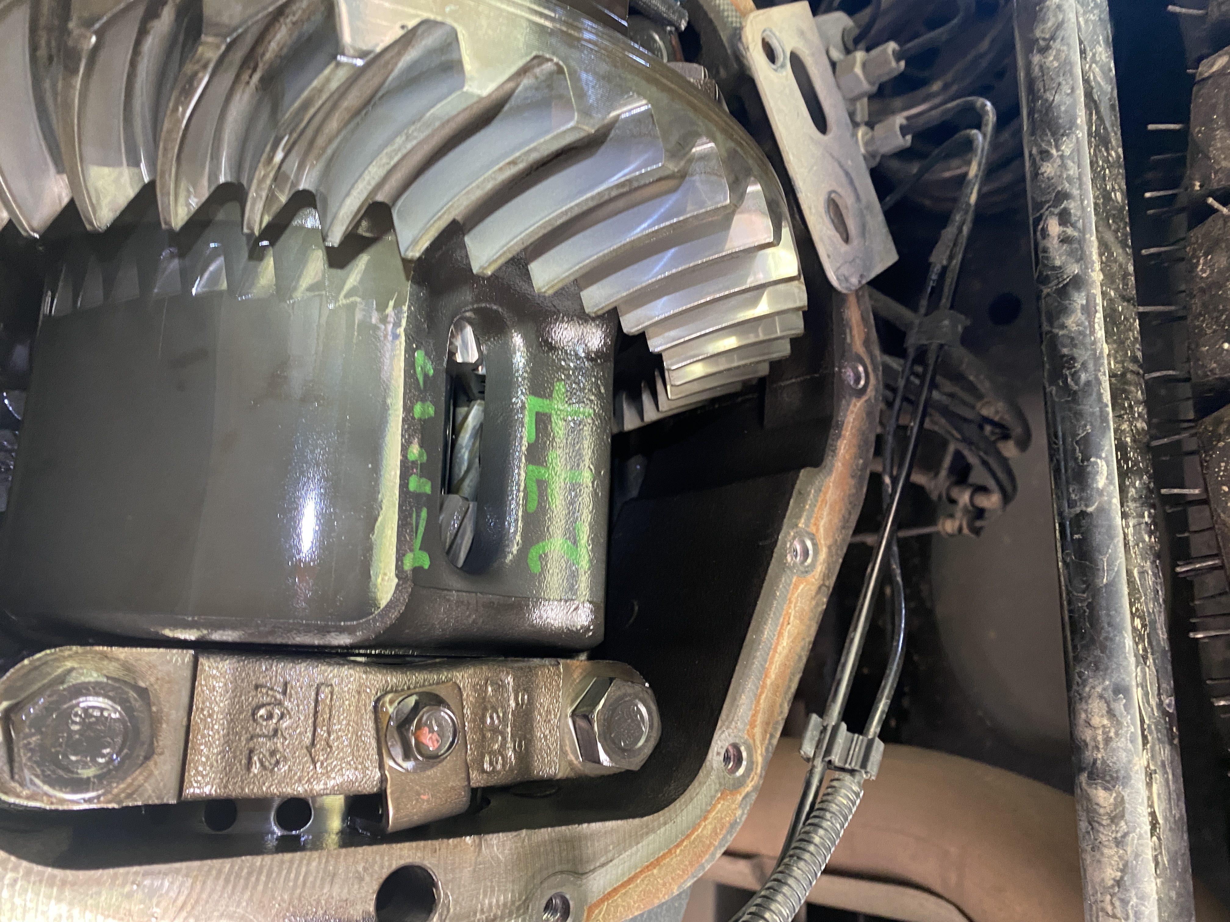

Then I talked to the tech, and better yet he came out to the truck and showed me how they get the lockers to work.
So tech says those clips don't have any function because they are there to keep the wires out of the way during assembly of the rear end.
So then he climbs into the drivers seat and says the following:
4Lo
swaybar disco button
then he turns locker dial all the way to both front and rear locked without stopping at rear only.
cranks the steering wheel back and forth, drives forward 5 feet and bam, both lockers locked, took 5 seconds.
He said the instructions in manual are crap.

I was trying to lock diffs on pavement. I just wanted to confirm they were working. It was the first ever attempt. I got the rear to lock, but couldn't get the front to lock.
I think tech shifted to drive before the swaybar disco and lockers Rodeoflyer
The tech said this is what they found to do that worked the best. I don't think he said you had to do it that way, it's just what they've found to do that locks both lockers. I definitely know what you're talking about TwinStick as far as not locking front to be able to steer. And the tech said exactly what you did; the rear has to lock or the computer won't allow front to lock.
I specifically told tech I could not get front locker to lock. So I think that's what he was addressing.

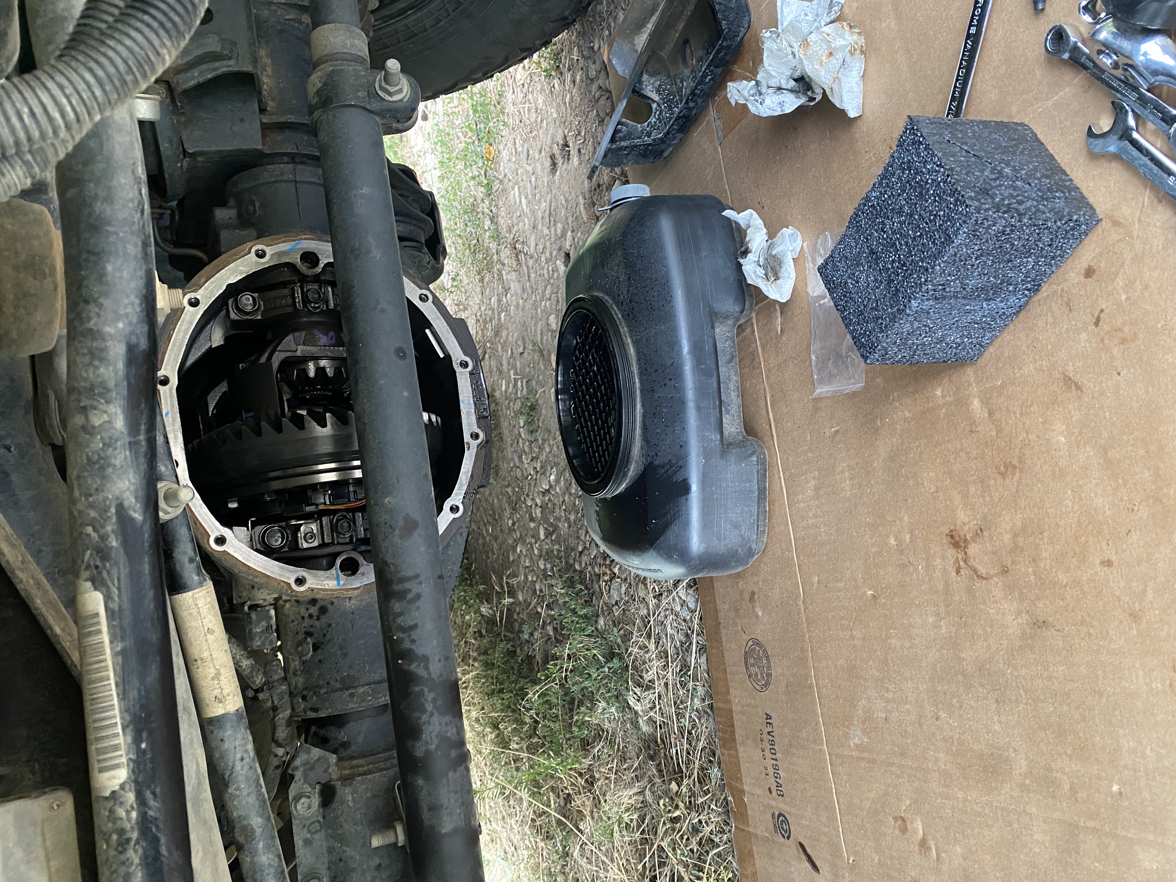

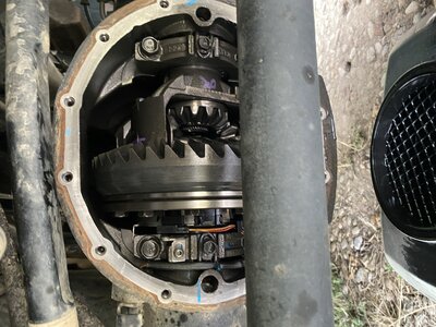

I just changed the axle fluid on my 2019 PW with 20,000miles. Front fluid was still very clean and clear looking, rear was transparent but pretty dark. Front plug magnet had lots of metal on it, rear had less, interestingly. Cleaned off the locker sensor magnets with a qtip as is suggested, they were pretty coated with metal shavings already.
Added FilterMag GP101 magnets into front and rear diffs (hopefully this helps keep the lockers happy), refilled with Amsoil Severe Gear 75W90. Front took about 2.5qts, rear took about 3.5qts.
Probably will increase change intervals to 40-60k now that the magnets are in the initial wear-in fluid is out. Maybe more on the front since that fluid doesn’t get actually worked as many miles.

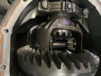

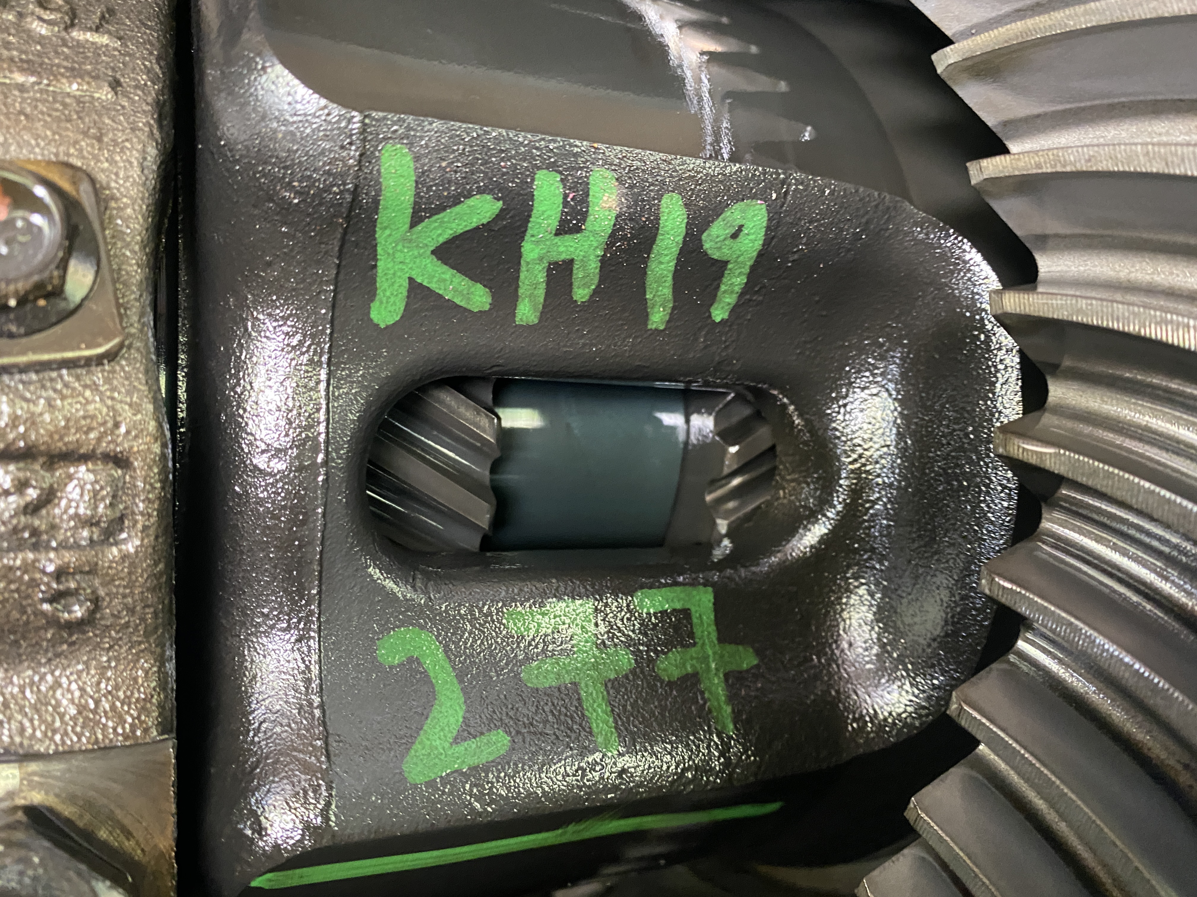

Worth noting: 2019+ Power Wagons still have helical gear LSD in the rear. “Regular” 2019+ 2500s with “anti-spin” rear diff is now a clutch-pack type LSD.

We've had lots of discussion years ago on the forum about the helical gear LSD. It doesn't work at all on sheer ice because there is not enough drive line torque to allow it to work. I had videos of my 2014 rear on ice with one tire just sitting there spinning... I think the clutch pack would work better for me (when I don't need the locker)btsbarton wrote: ↑Sun Aug 08, 2021 3:32 pmJust going to necro-bump this thread because it was helpful.

Maybe a bit better on ice depending on the preload.
Helical Gear type is smoother on the street, no clutch plates to wear out over time, no chatter, etc.
As you said, if I need to be locked up I can select that manually in the PW
2019+ let’s you lock the rear in 2WD

Changed my diff fluid recently and found my rear diff Filtermag was broken in half and had moved. Not sure what was going on, but I removed the front one and it snapped in half. I had not had any problems with them before, but I will not be running them any longer. I forgot to get picks when I was doing the change, but I figured I would put the info out. Not sure if anyone has had one bust.
- Posts: 5552
Re: FilterMag questions/ found loose part in rear diff. 3400 mi.
That's not good. Glad you found out now and not later in a bad way.ghaugo wrote: ↑Tue Nov 15, 2022 7:53 amChanged my diff fluid recently and found my rear diff Filtermag was broken in half and had moved. Not sure what was going on, but I removed the front one and it snapped in half. I had not had any problems with them before, but I will not be running them any longer. I forgot to get picks when I was doing the change, but I figured I would put the info out. Not sure if anyone has had one bust.
