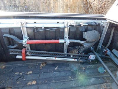

My Hi-lift is only a 48" but this is how I mounted it. I have to take the base plate off the jack but I modified that also with a bigger plate for use in snow and sand to help avoid sinking(It is attached to the jack with one bolt when stored) I used aluminum unistrut attached to the rails. No bolting thru the truck. The original tie downs can't travel very far but I don't use those anyway. The cargo divider could still be used to a point if I didn't have my shovel mounted that way. The other bar going from side to side is just to hold my pul-pal in place.

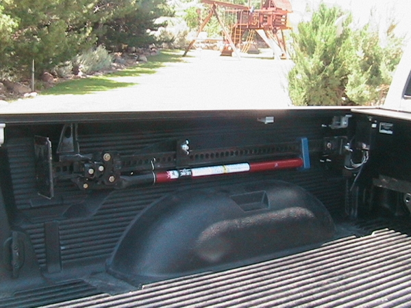

see pic. a 60" should still fit.
this was with my retractable cover. i also have one mounted like this in my current 2012' pw like this.
mike

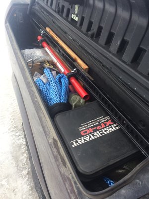

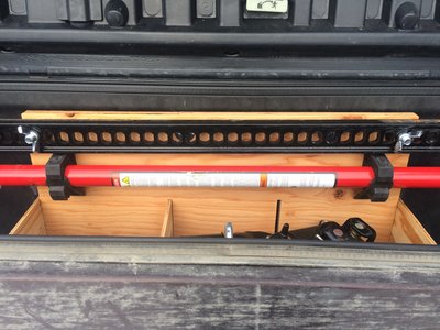

Post by Low_Sky » Fri Mar 16, 2018 9:32 pm
I know this thread is old, but here's how I just mounted mine in a RamBox truck. Took the jack apart to its major pieces: jack bar, foot (replaced the bolt with a 1/4" pin), handle (replaced the cotter pin with a single leg snap button), and running gear. I built plywood dividers and a jig to hold the jack bar and handle. The handle's held on with Quick Fist clamps, and the jack bar is on 1/2" bolts with wing nuts.
