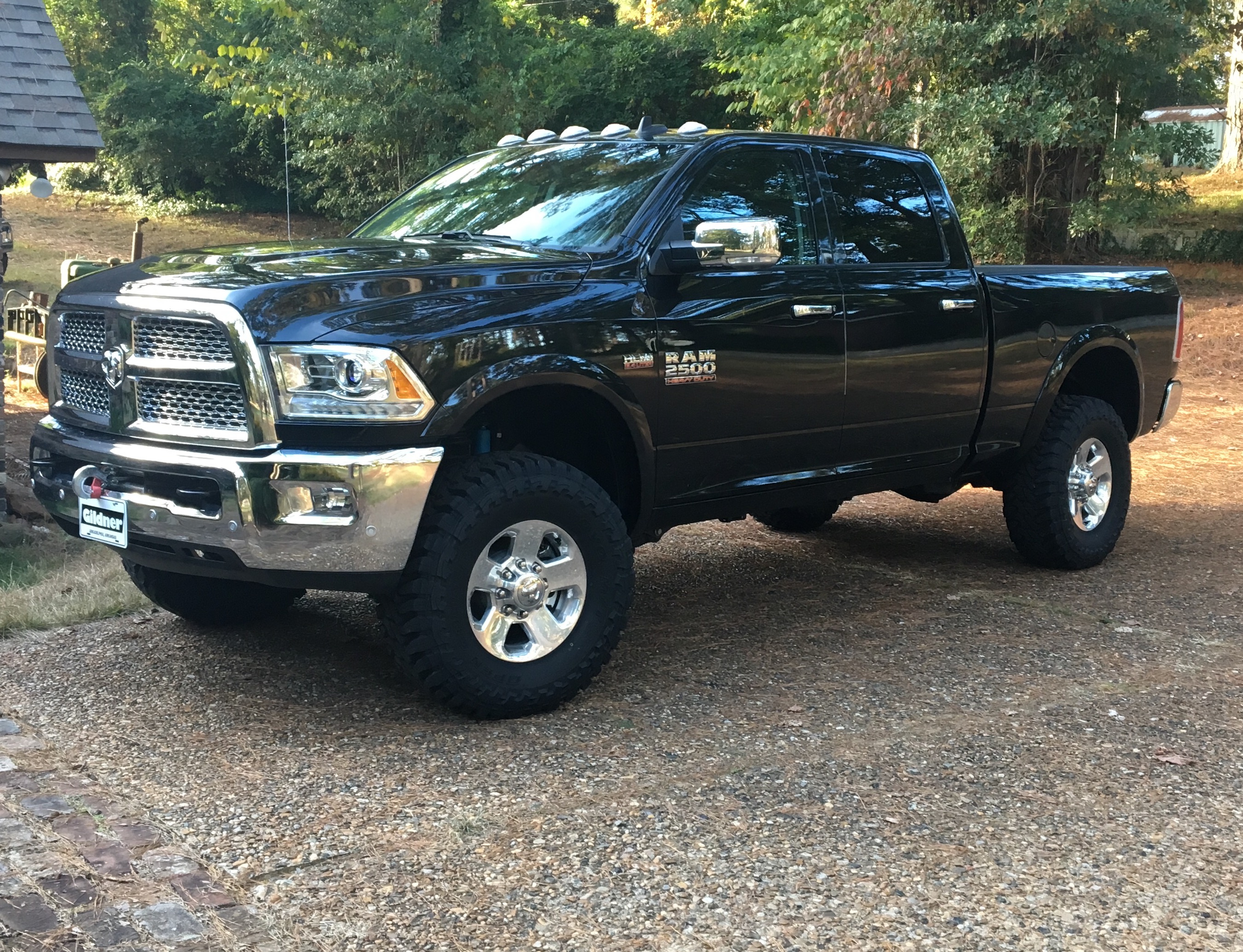

Hey guys I have a 2014 power wagon and it is time for new tires and of course I need bigger. I have read lots about what tire size will fit and what will not. I would like guys with 2014 or newer power wagons to really confirm what the biggest size tire I can run on a factory setup without cutting the fenders?? I don't want rub and I would like to run a 35 inch tall tire but I am worried about the 12.5 width rubbing on full lock to lock turns?? thanks in advance guys!!

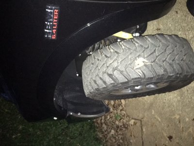

I've got a 2016 Laramie all stock except 35 toyo mt's no rubbing at full turn

JBW.....are the 35 Toyo's true 35x12.5 or metric?? because the true 35x12.5 are actually 13.2 inches wide under full inflation...

Yes they are 35x12.5r17 not the metric's
Jbw1011
Posts: 21
Joined: Sun Aug 07, 2016 9:07 pm
Re: 2014 power wagon new tires bigger size
Post by Jbw1011 » Thu Nov 10, 2016 6:24 pm
Sorry only pic I have that is small enough right now
Jbw1011
Posts: 21

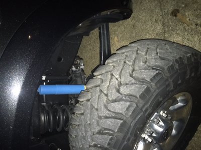

Post by Jbw1011 » Thu Nov 10, 2016 6:29 pm
One more the drive slopes a lil so the front looks a lot lower than it actually is.

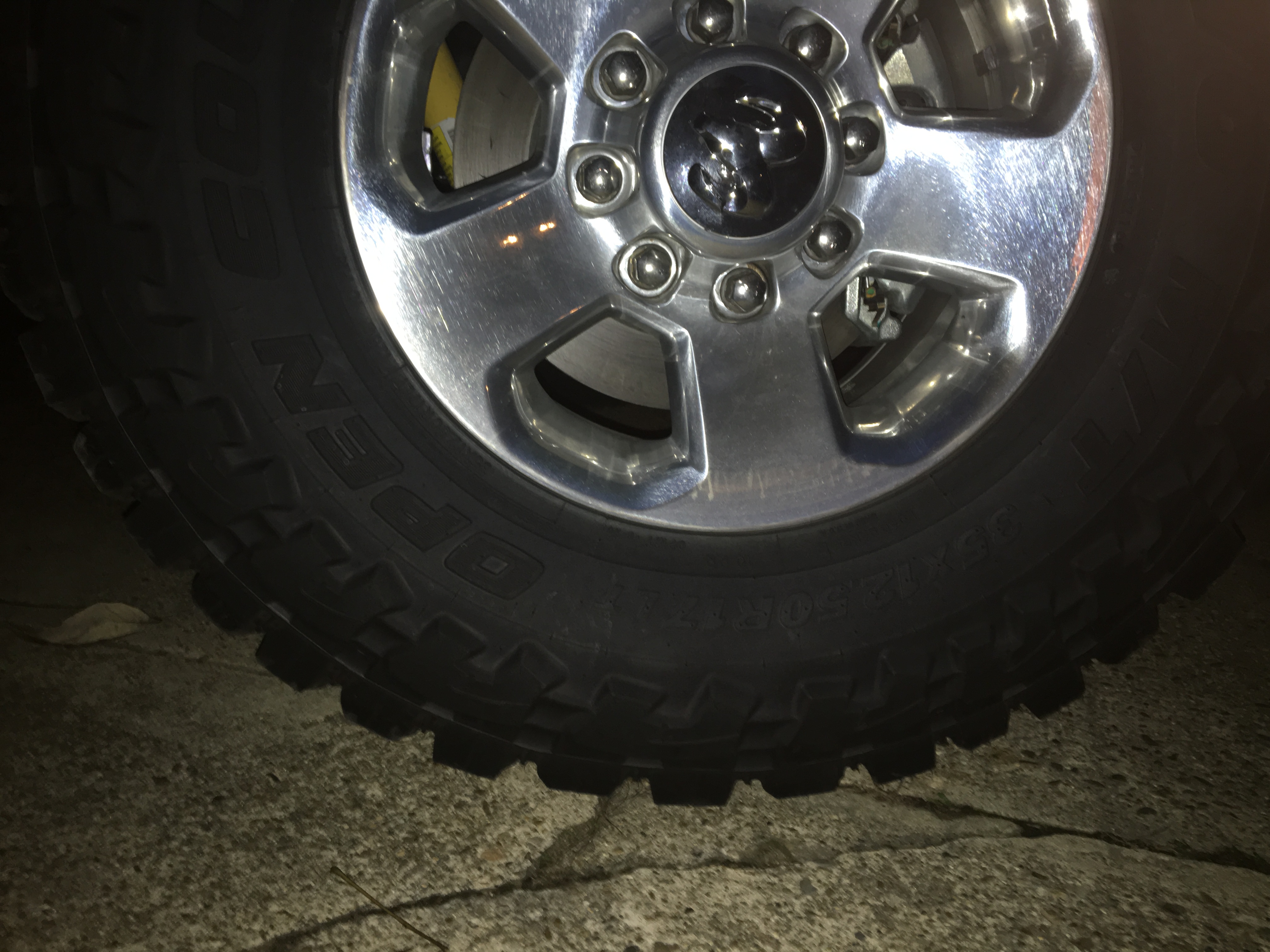

Post by Jbw1011 » Thu Nov 10, 2016 6:58 pm
Sorry little dark outside

Post by RustyPW » Thu Nov 10, 2016 7:57 pm
The 35" Toyo MT's are wider then anyone else's 35's.

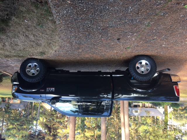

Post by Jbw1011 » Thu Nov 10, 2016 8:09 pm
Couple more

thanks I know now i am getting true 35 x 12.5

No problem i only test drove it with the stock tires,but can't really tell a difference other than its a tad taller. Not any rougher or louder.

I put 35/12.5/17 KO2's on my 2014 with stock rims before leveling. No rubbing.

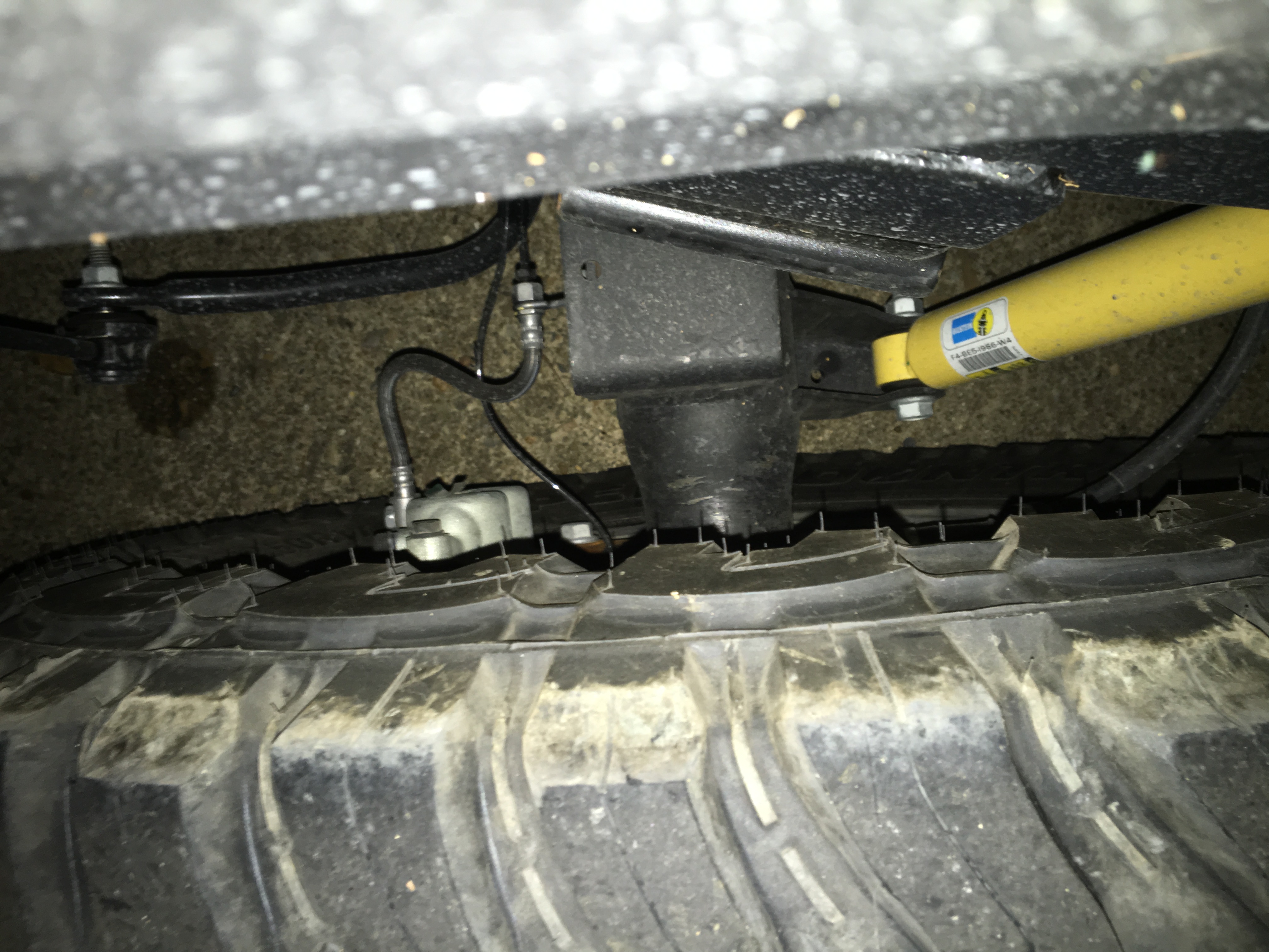

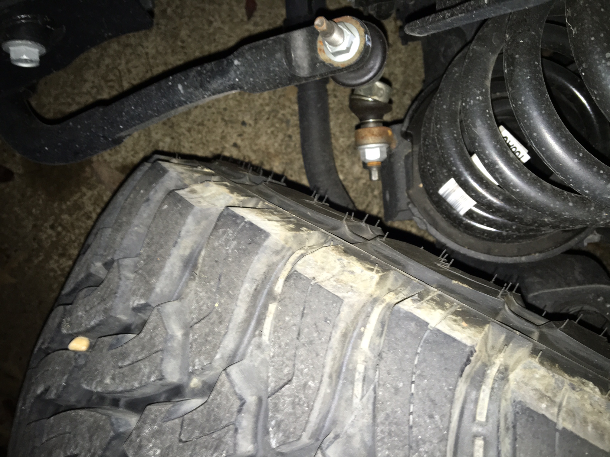

Here's some inside the wells.
Thanks for those pics. I had 35/12.5R17 Toyo RT's put on today. Drives so much better! No rubbing. I can only describe it as more grounded and less floaty. I think these trucks are just too heavy for D's. No more body roll when cornering.
As for chain fit, it looks like the front is tight if you get a chain that wraps around too far down the side wall. Like a camlock should be okay. The rear seems to have room for days. Thanks for all the effort and the pics!!! Really helped!

Post by olyelr » Tue Nov 15, 2016 6:47 am
By the looks of that picture, it appears the tire rubs the sway bar from time to time, which i would highly expect with stock wheels and the wide of a tire.

Jbw1011 wrote:Not saying it won't hit track bar, but I haven't yet. I'm in south Arkansas so not a lot of opportunities for chains. Did a little flexing last weekend trying to get it to rub so far nothing. Looks like for my use "mostly mud & a few rocks" I made a good choice in size.
What I was referring to is the sway bar... the tire will never get to the track bar. That picture of the front wheel turned, it looks like there is some paint wore off the sway bar right where your tire "would" hit. That is the common place for rubbing.
