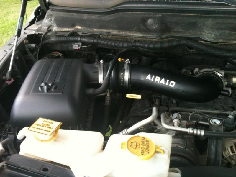

The basic concept is to provide a straight tube from the air filter box, remove the resonator, and go directly to the throttle body. In theory you would get less airflow resistance and a few extra HP and better throttle response while still having the good filtering careerists of the OEM filter and filter box.olyelr wrote:I guess i am just a little lost here.... why would you want to replace just the tube?

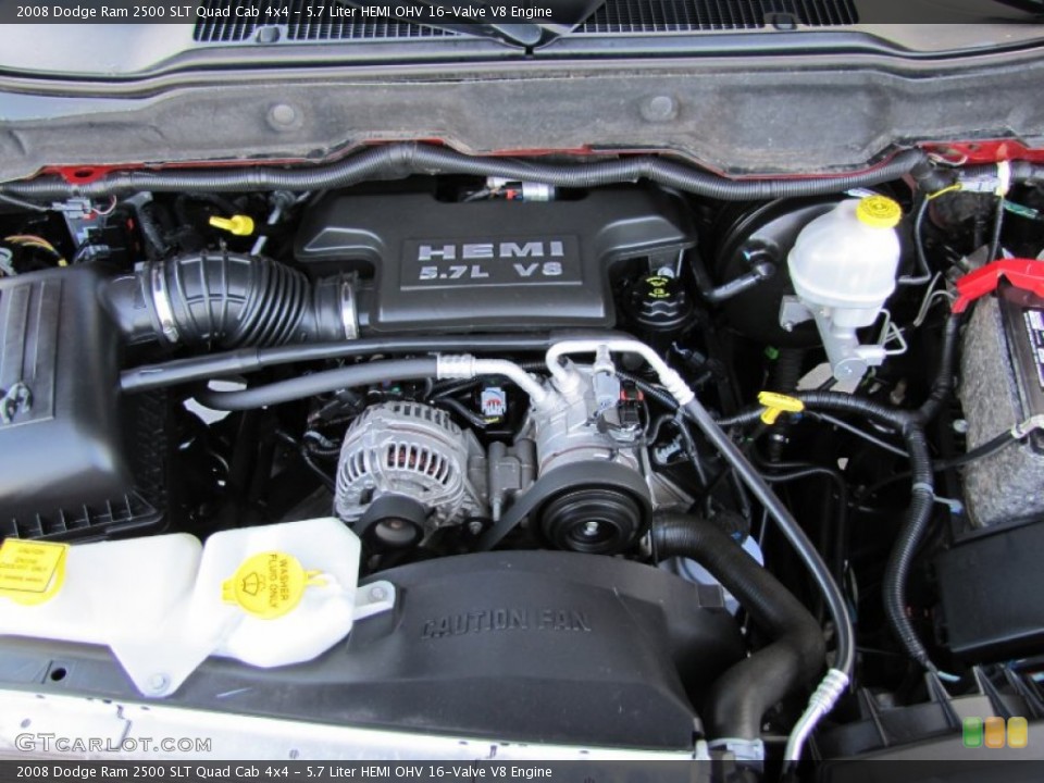

For example on a 3 Gen 5.7 Hemi:

Some of the aftermarket intake manufacturers have posted before and after dyno numbers - so a small increase in peak hp is obtained. But this apparently comes with a significant increase in intake noise under load at higher rpm's - so much so that many people pull them back off thinking that the additional power is not worth the loud intake howl. Perhaps if you and your passengers are hard of hearing then it wont matter.

The intake noise is why I put the intake tube on my 5.7
Re: 6.4 intake tube
I had an AEM Cold Air Intake on my 2004 Ram and HATED the extra noise I got from it. I honestly couldn't tell if you if I gained any HP, but I sure gained a lot of noise. If I had kept that truck longer I would have gone back to the factory setup.
Re: 6.4 intake tube
x2 I removed my aftermarket intake for the same reason the noise got old after awawhile, the resonator is there for a reason.04Ram2500Hemi wrote:I had an AEM Cold Air Intake on my 2004 Ram and HATED the extra noise I got from it. I honestly couldn't tell if you if I gained any HP, but I sure gained a lot of noise. If I had kept that truck longer I would have gone back to the factory setup.

If you just run the tube and keep the factory air box it isn't near as loud as the complete CDI systemBill2014 wrote:Some of the aftermarket intake manufacturers have posted before and after dyno numbers - so a small increase in peak hp is obtained. But this apparently comes with a significant increase in intake noise under load at higher rpm's - so much so that many people pull them back off thinking that the additional power is not worth the loud intake howl. Perhaps if you and your passengers are hard of hearing then it wont matter.
