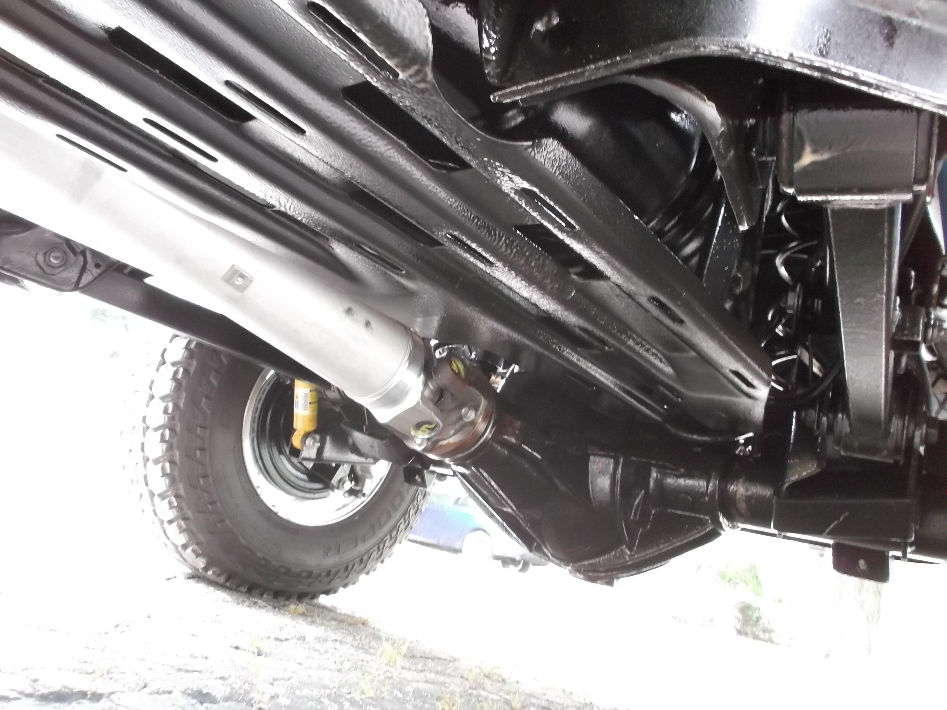

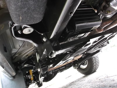

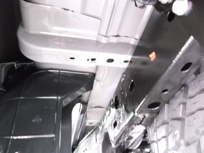

I have a pretty crappy camera so lets see how this works.
It is kinda hard to see other than in one of the pics, but I can assure you, It is on VERY thick. I tried to post a pic of my truck and it is 2.08 MB which is too big according to the forum error I received. Oh well. No idea how to resize them.
Edit... I have driven down about 3 miles of dirt road between the time the fluid film was applied and the time these pics were taken. Dirt and dust isn't as bad as I thought it would be. I don't really care, as long as I don't get rust in two years!

Thanks for the pics 65plymouth! Man this is really intriguing me.
Hey are those the 285/75 st max's? Wheres the pics?!?!?!?
