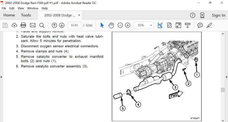

Catalytic converters are in a different location on the newer models.
Posts: 1002
Re: Long Tube Headers
Post by cruz » Fri Jul 01, 2016 3:37 pm
Pit Slave wrote:Catalytic converters are in a different location on the newer models.
Chris, here's a pic from the 2002-2008 FSM, my '05 looks just like the pic. What changed ? I guess I'll try calling TTI and see if someone can explain to me why they don't fit a 2005, hopefully I won't get the same guy that Dodger talked to.
Hmm. If that's the only difference it sounds like it would be a simple matter to relocate or delete the catalytic converters.
