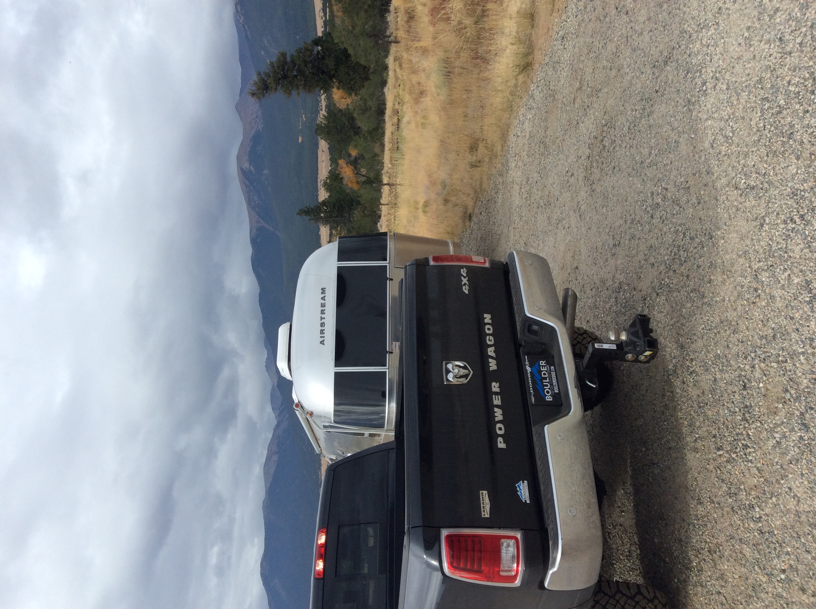

Anyone else besides me tow an Airstream? I feel it's the best combination of vehicles in their segment. Post some pics up!

Looks nice. Classy.
Looks like you could use a weight distributing hitch.

Post by Bill2014 » Sun Jun 19, 2016 9:28 pm
FirerescuePW wrote:Looks nice. Classy.
Based on the road lines - it looks level to me...

Post by RustyPW » Sun Jun 19, 2016 9:46 pm
I agree. Does look nice. :rockon:

Post by Zybane » Sun Jun 19, 2016 10:22 pm
The pic was taken right before I installed the ProPride 3P weight distribution hitch. Made a WORLD of difference!
I wonder how much I could "go over" the puny 1,300 lbs cargo weight rating with my Laramie PW and not have the springs touch the bump stops. :lol:

Zybane wrote:The pic was taken right before I installed the ProPride 3P weight distribution hitch. Made a WORLD of difference!
Under no circumstances should the springs hit the bumpstops... But i dont think that is what you really meant.
My payload number is quite a bit less than that if i remember correctly. Probably because i have the rambox option.
Nice looking setup! Yeah, the weight distibution hitches are a must. And they do work very well!
