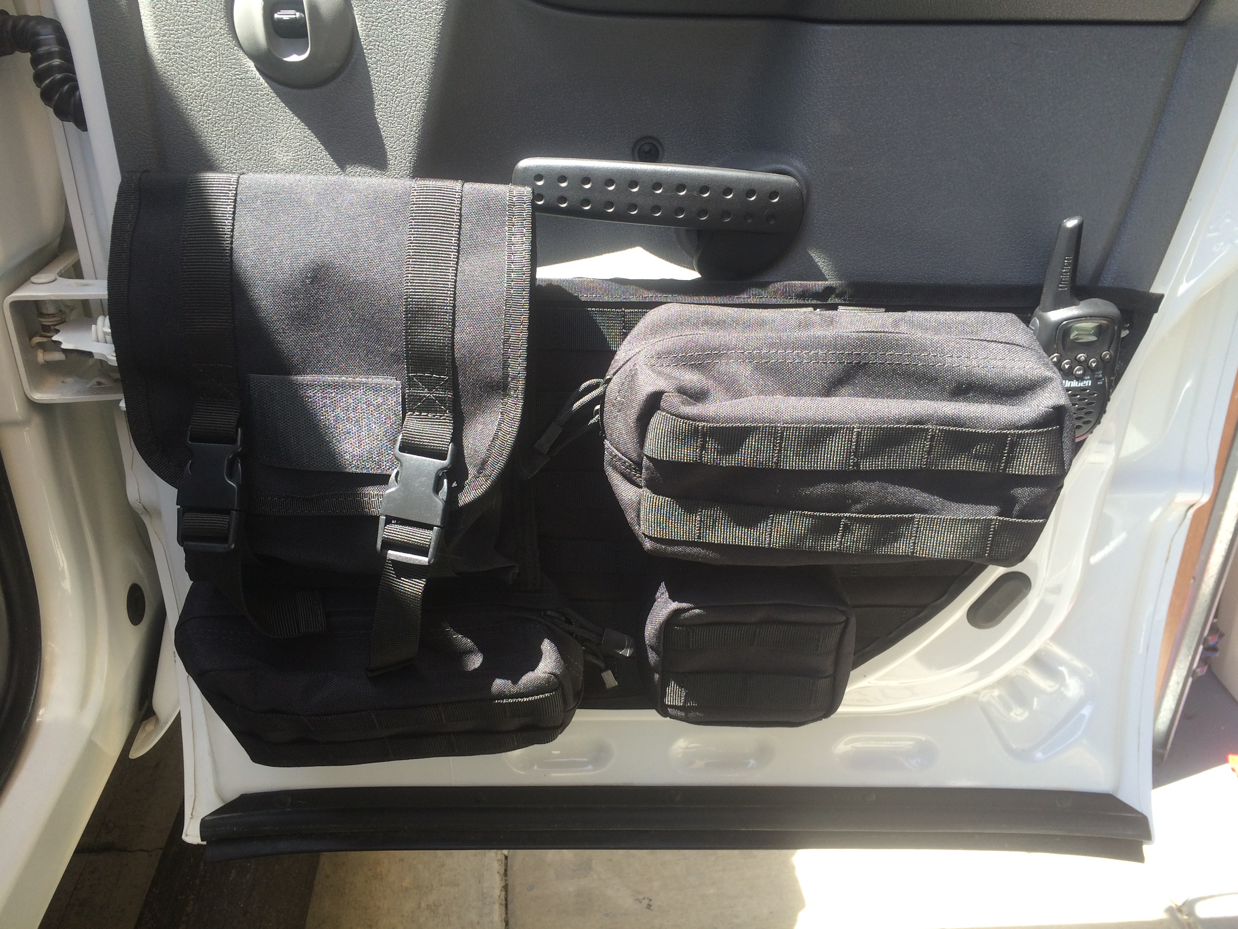

I'm pretty sure all of the 4G trucks have storage pockets in the rear door panels (correct me if I'm wrong), but I haven't seen anything on a 3G, or even an aftermarket add-on option. It would have been so easy to just mold the same pockets in the back doors as they put in the front doors. Whoever the design engineer was that Dodge/Ram brought on board for the 4G was really thinking outside the box: rear door pockets, in-floor storage boxes and the Rambox bed, all great ways to take dead waisted space and turn it into something functional. I like the tactical seat covers that are available for our trucks, but if you carry passengers in the back seat, they really get in the way. So in my quest to add more storage capability to my truck, this is what I came up with.
There's 2-3" of space between the door panel and the rear seat when the door is closed.
I started by buying a 24"X32" tactical MOLLE panel on eBay.
Then I made a pattern of the shape of the door and cut out the MOLLE panel for both sides.
Then I went to JoAnn's fabrics and got a roll of ribbon to bind around the edge with my wife's sewing machine.
Then I got these snaps with screw studs in black.
I laid out where I wanted the snaps to be on the door panel thru the reinforced portions of the fabric.
Then I used a soldering iron to melt thru the fabric and used the tool shown to set the snaps.
The finished product. I guess I could have gone up higher around the door handle, but then I would have needed to buy two MOLLE panels to do that.
Then shop the internet or favorite outdoor store for the pouches you want.
I would recommend going with pouches that are a little smaller than you think will fit. I got a couple that were too big.
That's it for this installment. Have a good weekend and happy modding! :patriot:

Nice work! Great idea. I like the versatility of the Molle pouches. It allows you to taylor the sizes for each purpose.
