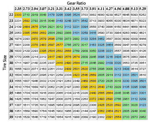

And just to add it in, the gear ratio/tire size graphs dont factor in the added rolling resistance of wider/heavier tires either.
Re: Gears & Tires
Post by olyelr » Wed Jun 08, 2016 9:44 pm
Here is one I pulled off of google...

When looking at the above chart, don't forget that it assumes a 1:1 ratio in the trans so, your final drive ratio for highway cruising will differ dramatically due to the double overdrive of the six speed auto!
