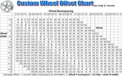

Post by 14PowerWaggy » Thu May 19, 2016 1:56 pm
This was helpful when I was deciding on wheels for mine... Factory wheels are 17x8 with 6" of back spacing so by the chart they are a +38... I run 20" Trail Ready Wheels on my wagon and absolutely love them, however I'm on 37's and not 35's... My truck rides no worse with the 20's then it did for the few months I had the factory wheels on 35" tires... My current set up is 20x9 with 5.8" of back spacing on 37x12.5x20 Nitto Trail Grappler MT... They are wearing a little faster than I thought they would but have been a good tire for me... I now have about 12,000 miles on them... I won't be running them again and will go to a Toyo... More than likely the RT...

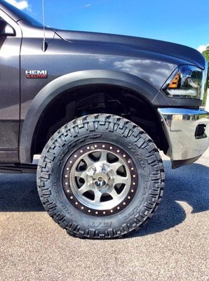

Post by 14PowerWaggy » Thu May 19, 2016 2:10 pm
My set up...

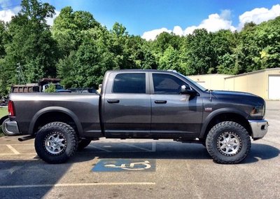

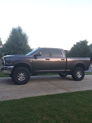

Post by GunniPWguy » Thu May 19, 2016 3:19 pm
14PowerWaggy wrote:My set up...
Can we see the whole truck just for the fun of it Powerwaggy? Congrats on the new truck orkan. :rockon:

Post by 14PowerWaggy » Thu May 19, 2016 3:57 pm
Sure thing...

Post by orkan » Thu May 19, 2016 4:01 pm
I called and talked to Aaron at Thuren, and he said 2015 power wagons start with about a +56 offset and that a +18 to +20 would be optimal. He thought I could probably get away with up to a 0 offset, but it would get awfully close to the front of the wheel well.
Next question... where's the best place to shop for wheels that has a search filter for offset?!??! Bonus points if they can install tires and balance them up and then ship the works to my door. ;)
