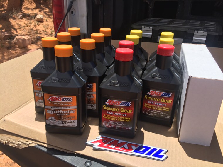

Fluid is cheap, compared to an axle or rebuild. For some reason Dodge/Ram AAM axles seem to sheer the oil between 10-15,000 miles, even Royal Purple & Mobil 1. I have added a qt of Lucas Lube to mine when doing a drain & fill & cleaning the magnets. That seems to make it last 25k or more. My trucks (all 3 Dodge's) have never had an axle problem. I overfill them on purpose, so the pinion bearings stay lubed. Every single "dodge axle failure" I have looked into, that was covered under warranty, came back with the same quote from dodge---"pinion bearing failure due to lack of lubrication". So, my questions are: if the truck was bought new, checked & serviced before delivery, how can the pinion bearings fail, if no one messed with the diff & there are no leaks ??? I think they are under filled on purpose. What other explanation can there be for 438,000 hits in 0.49 seconds when you google "dodge axle failures" ???. I did a lot of research & talked to a lot of people on different forums before i bought my first dodge.

Post by OffroadTreks » Sun May 15, 2016 6:18 pm
I just changed the rear this morning. Holy shizzle was that black oil. I still need to do the front and still need to check all the connectors and hit them with electrical cleaner. Just ended up wasting half my day on the sliders.
The locker isn't blinking now, but it was this morning. So that's good. 8-)
