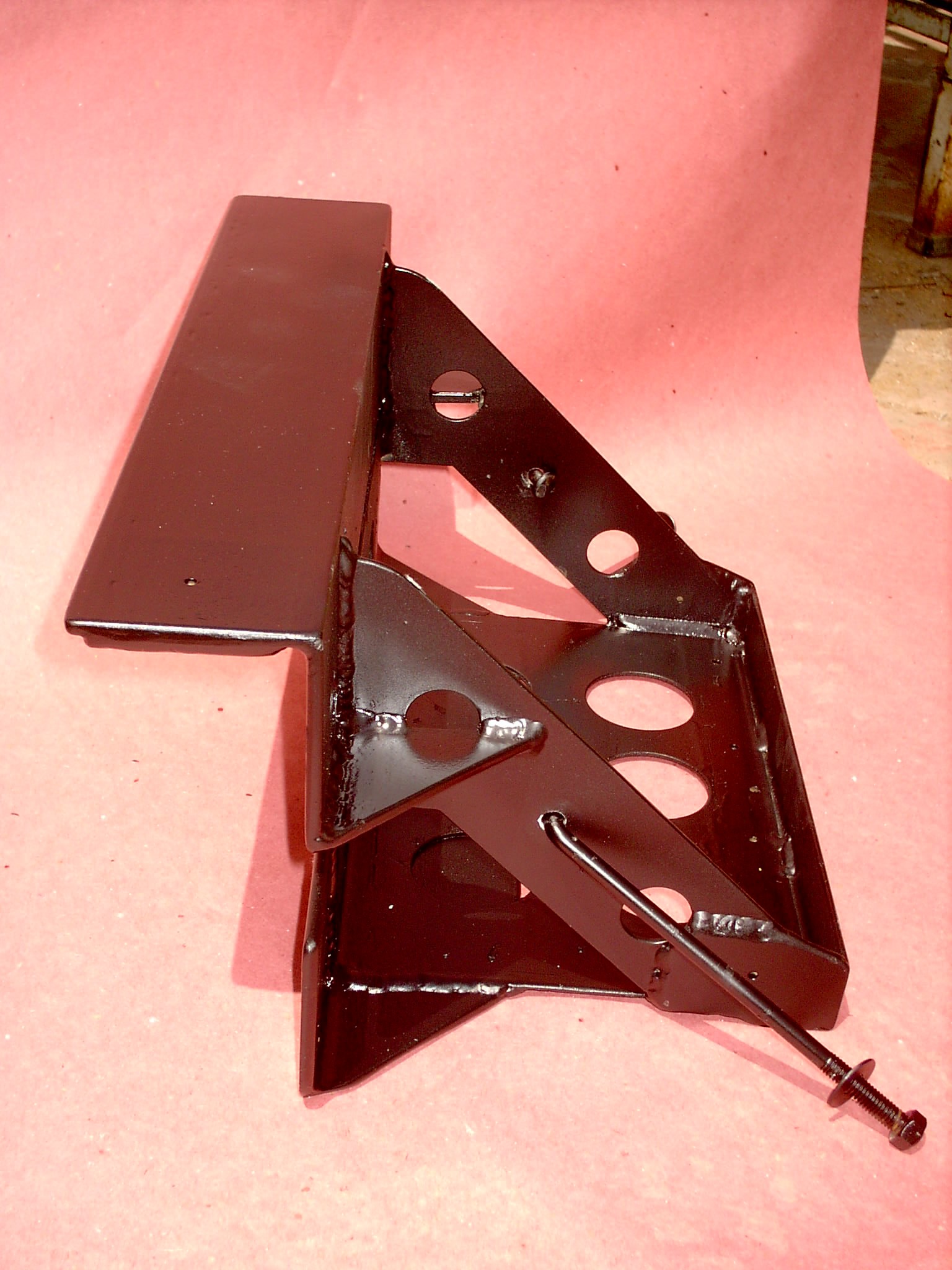

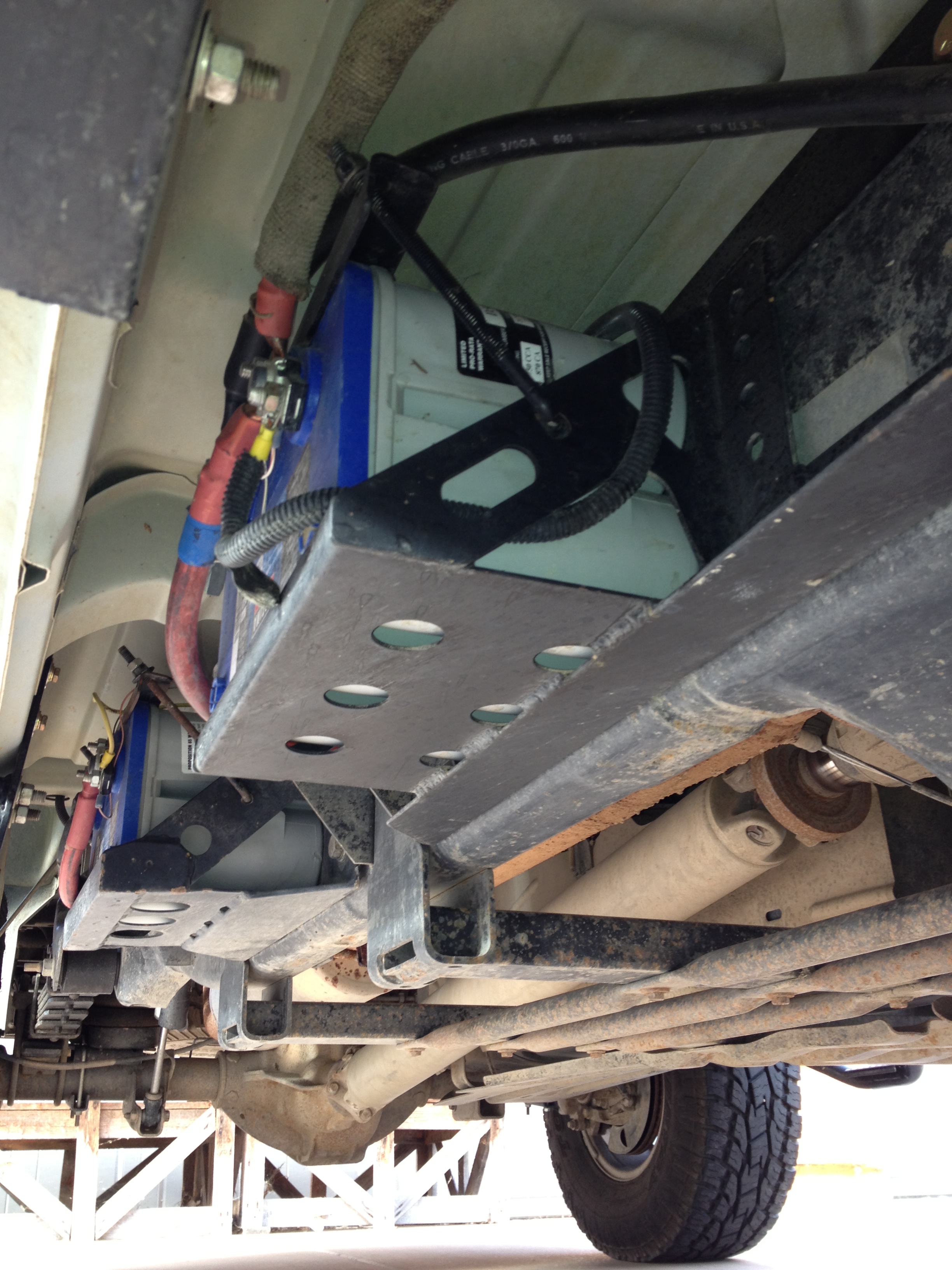

Currently have two batteries mounted to the frame rail under the passenger seat. Used boxes that I bought from Summit Racing, then modified them with some angle iron so they could hang from the top of the frame rail, bolted through with 1/2" Grade 8 bolts. Tucked them up as high as I could to protect them, but also added angle iron to the bottom of the box to take any impacts. Battery cable sheathed in milsurp kevlar braid and routed to engine compartment through inside of frame. So far, no problems.Do you have a picture of your battery mount?

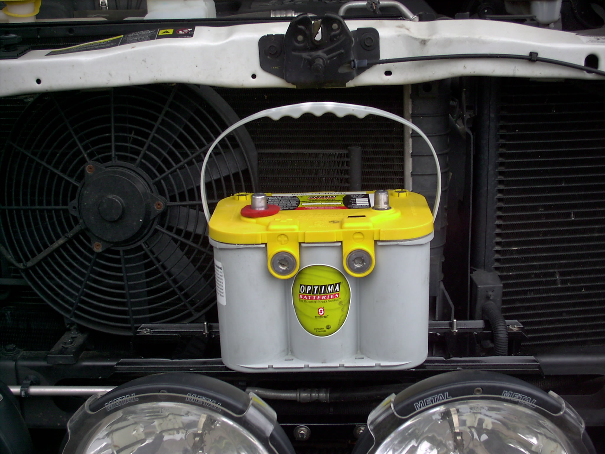

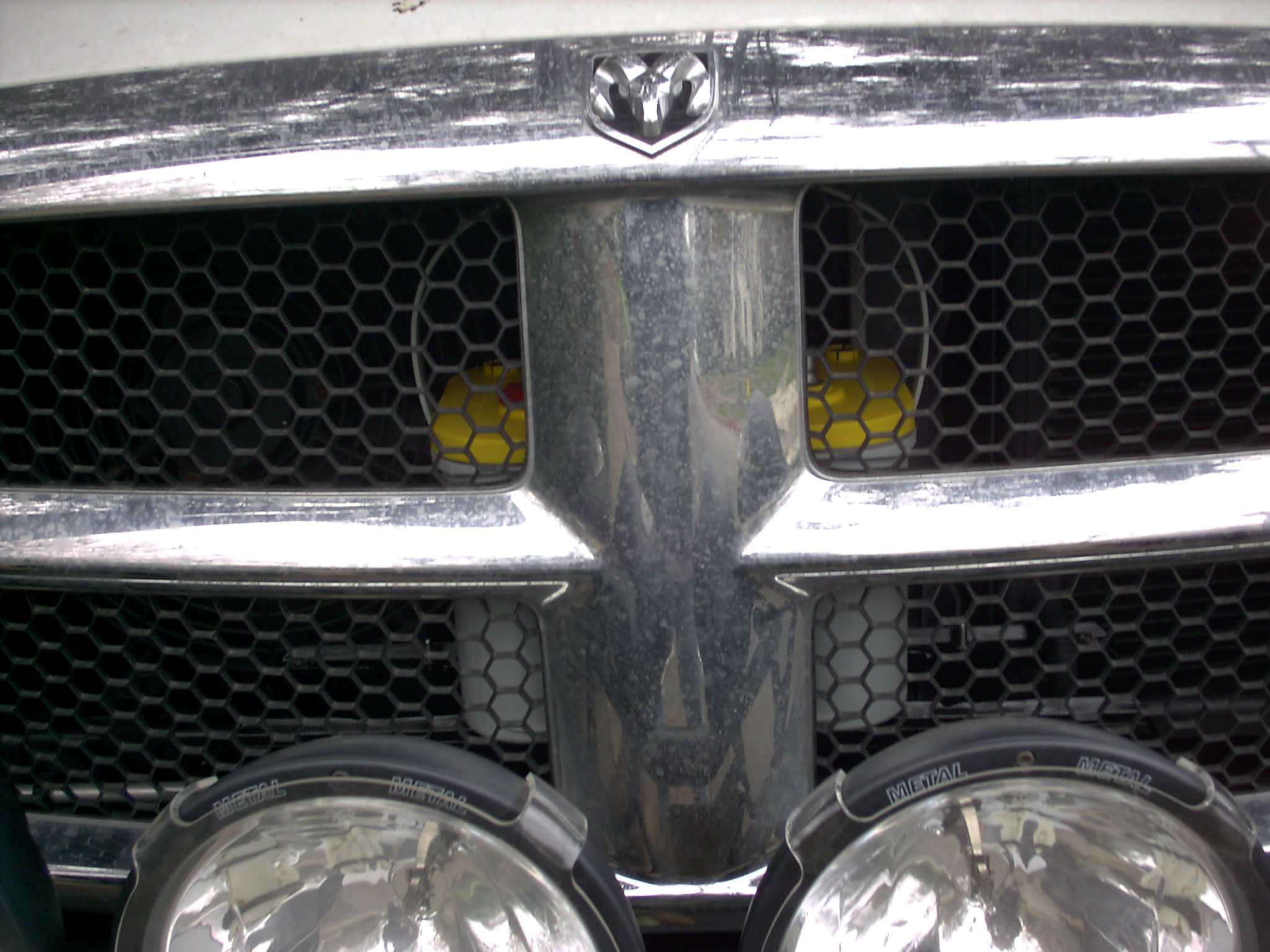

Another alternative is to mount the battery behind the grill on a cradle fabbed to bolt the the lower core support. I mounted my compressor to the cradle, but test fitted for batteries before I bolted in the compressor. Can easily fit two Grp 34 Optimas in my 3G.
