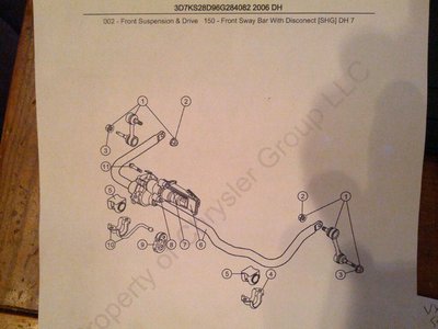

These are pics of the 2006 PW smart bar parts.

Re: Smartbar part #
Thanks everyone for your help. My stabilizer bar still disconnects, it is my lockers which are not working. I believe the problem is in the Smartbar, the rear locker light is flashing all the time.
Thanks AceMan for the parts breakdown. I was under the impression the Smartbar had to be ordered as a whole unit. You can apparently order the actuator PN #68044412AA separate, although it appears to be most of the cost at $1460.50, but still $471.50 less than ordering the whole bar.
http://www.mmaautoparts.com/nsearch.htm ... 5101927010
I know there have been those which have wired the lockers separately, I'll have to search the threads. Does anyone recall someone wiring the lockers separately from the Smartbar, but still using the OEM switch to activate them? I am pretty good at mechanical repairs, but am clueless at electronics.

Re: Smartbar part #
That I can't answer. I do know, and I think you are aware of it, that eerything goes through the smartbar. If that doesn't work, then no signal will go to the lockers.
I know that it's possible to "trick" the computer playing around with the bar's wiring, but that takes a little electronic component and circuitry knowledge (diodes, resistors, etc). I've heard of others just disconnecting it from the computer and hard wiring it back to the dash with a dedicated switch for the bar, front locker and rear lockers. There are two hots going to each, if I remember, a low voltage and a high voltage. One's for a sensor, and the other is the actuator. Someone had posted a breakdown of those parts on a DT thread somewhere (buried among thousands of threads by now), so I can't help there.
If it's still under warrranty, you have the option to take it to the dealer. I don't think you need the whole unit. I know that's how they sell it, but it's possible to possibly just clean it out and put some dielectric grease in there, which is what I've seen others do. Maybe someone else can give you more specifics on this, such as Pit, Russ, Eric, etc.

Re: Smartbar part #
We know it can be done and it seems we're getting closer all the time. The key is getting the proper voltage from the hard wire into the axle ...AceMan wrote:I know that it's possible to "trick" the computer playing around with the bar's wiring, but that takes a little electronic component and circuitry knowledge (diodes, resistors, etc). I've heard of others just disconnecting it from the computer and hard wiring it back to the dash with a dedicated switch for the bar, front locker and rear lockers. There are two hots going to each, if I remember, a low voltage and a high voltage. One's for a sensor, and the other is the actuator. Someone had posted a breakdown of those parts on a DT thread somewhere (buried among thousands of threads by now), so I can't help there.
http://www.dodgetalk.com/forums/showthread.php?t=361532
I wish I knew more about electronics.

Re: Smartbar part #
Wow, that's a heck of a build. I replied to that thread. I don't think the electronics are that hard, as long as the wiring diagrams are available. I see he posted the locker wiring, which is what he used to hardwire them.cruz wrote:We know it can be done and it seems we're getting closer all the time. The key is getting the proper voltage from the hard wire into the axle ...AceMan wrote:I know that it's possible to "trick" the computer playing around with the bar's wiring, but that takes a little electronic component and circuitry knowledge (diodes, resistors, etc). I've heard of others just disconnecting it from the computer and hard wiring it back to the dash with a dedicated switch for the bar, front locker and rear lockers. There are two hots going to each, if I remember, a low voltage and a high voltage. One's for a sensor, and the other is the actuator. Someone had posted a breakdown of those parts on a DT thread somewhere (buried among thousands of threads by now), so I can't help there.
