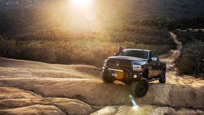

Here's a couple of pictures of the AEV Power Wagon flexing. I still think it looks pretty capable.

The pic of the aev ram flexing isn't as impressive as what stock 3rd gens could do before lifting the dog leg. But they are more a generic "we build a truck" for the oil big spenders who know jack all about their trucks and want it tall with 37"s. And they had <-- key word right now, more money than brains. So aev makes some shiny parts and puts a hefty price tag on it but in reality they are just getting another "lift". And the dealerships are loving it cause it helps sell new trucks and completely soak the young kids who just got their first 8 grand 2 week paycheque. Why are we not past the aev stuff yet. It's not improving the power wagon enough to justify anything more than a bumper and snorkel. Otherwise it's great advertising and product placement.
