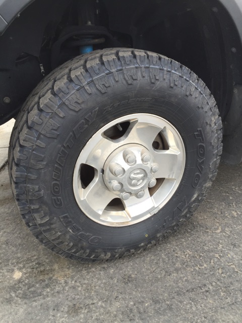

Im running toyo at2 extreme 35x12.5R17. I have a level kit but they will fit the new gen stock just fine.
