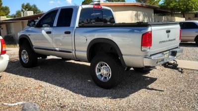

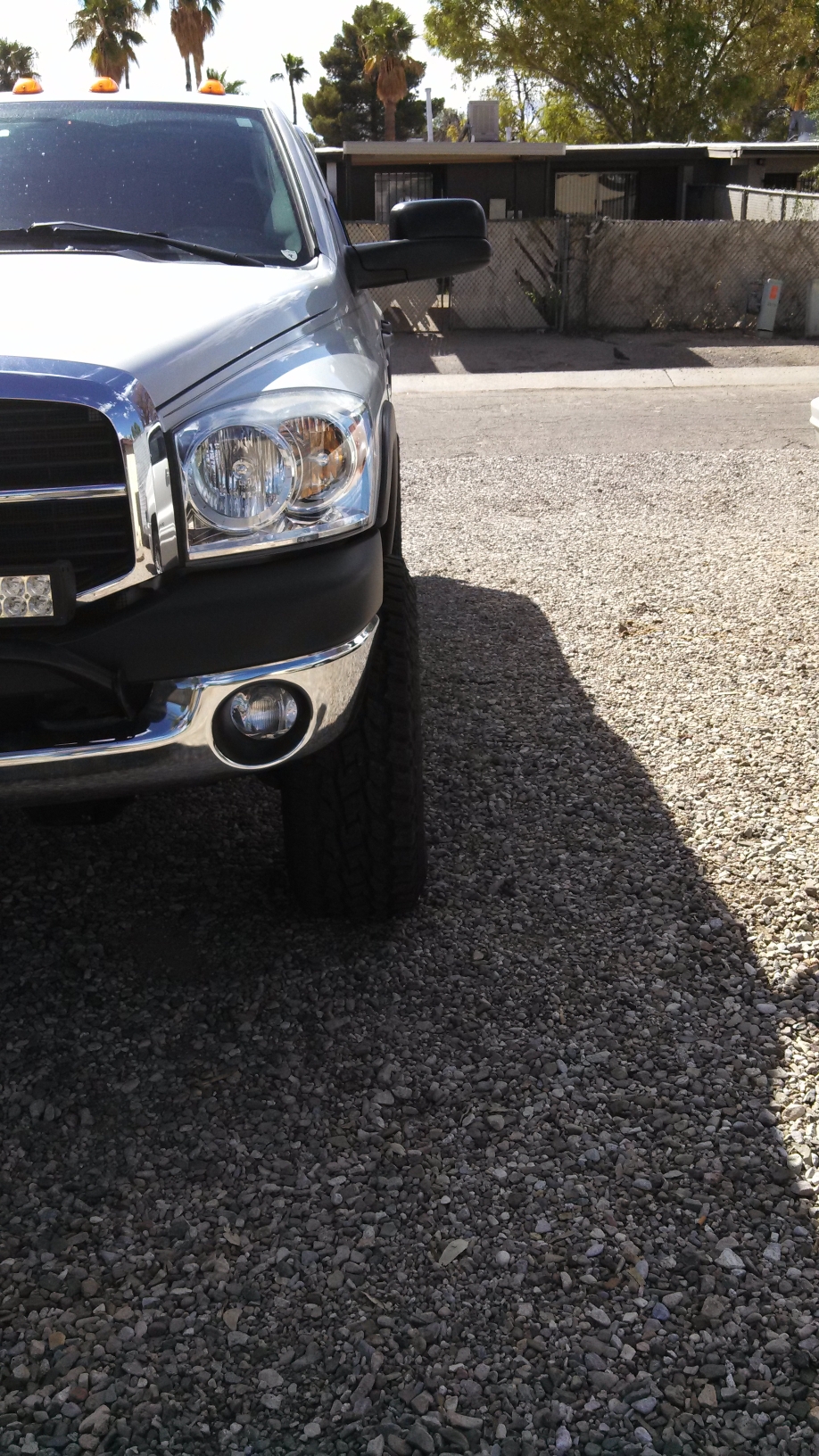

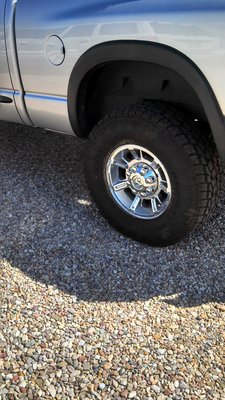

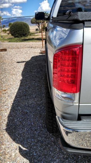

I went the H2 route and really like the look and fitment of the wheel. Wider wheel accommodates the 35x12.5 tire (very minimal rub on full lock in reverse/easy to pull or trim liner) and looks great with the offset, sits almost flush with the wheel wells. As others said I can still air down with the internal beadlock and its plenty strong. Paid $225 for a set of 4 on CL, so they can be had for cheap too!
Re: Wheel Talk
Crappy pic of them on a 4G:
https://www.dropbox.com/s/8oza15eqxhw58 ... 0.jpg?dl=0
